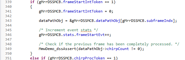

    ASSERT ERROR: line num 349: file E:/Saeed/......
    Please see line 349 here:
    Here are some run time values for some important variables after the assert:
    gMrrDSSMCB.stats.frameStartIntCounter:1
    gMrrDSSMCB.stats.frameStartEvt :1
    gMrrDSSMCB.stats.chirpEvt : 0
    gMrrDSSMCB.stats.chirpIntCounter : 4
    gMrrDSSMCB.chirpProcToken: 1 '\x01'

    Thank you for the log.
    The assert at line 349 usually happens when the processing for current frame has not completed before the next frame is starting.
    This may happen if you are running code that is not optimized for speed. There are optimization compiler options that should be set to highest level to avoid this problem.
    In your case, on thing that is strange is the "gMrrDSSMCB.stats.chirpIntCounter : 4" Usually this value should be the number of chirps in the frame because the counter is incremented for every chirp interrupt.
    Are you using 4 chirps in the frame.
    Another concern are the mailbox errors reported in your log. Do you know where they are coming from?
    It is possible that there is some corruption earlier in the code

    gMrrDSSMCB.stats.chirpEvt : 0  means that processing for the first chirp has not even started.
    This means that the second frame has started before even the first chirp was available.
    In other words, gMrrDSSMCB.stats.frameStartEvt is flaged before gMrrDSSMCB.chirpProcToken.
