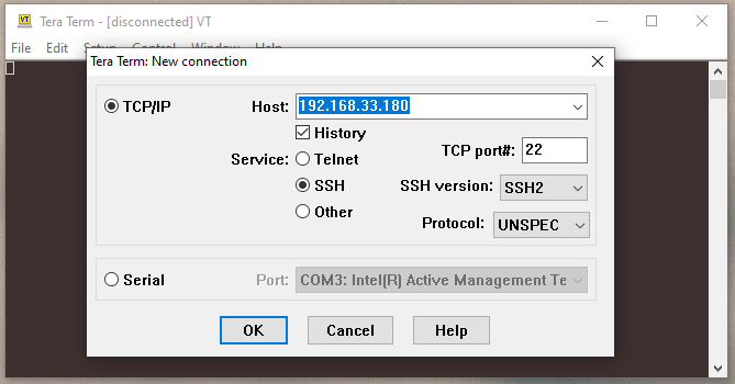

    Can you log into the UART terminal hosted by the EVM and verify that the files are being stored in the /mnt/ssd/ folder? Just want to make sure the data is really there.
    Can you check if the relevant ports are open on your host PC? Are you directly cabled to the MMWCAS-DSP-EVM Ethernet port?
    mmWave Studio transfers the files from the MMWCAS-DSP-EVM SSD through a WinSCP session.Can you try to manually log into the SSH/SCP server the MMWCAS-DSP-EVM hosts and see if you can move the files? There might be some OS permission restrictions on mmWave Studio or on the SSH/SCP ports used.
    In Windows I typically use the terminal program Terra Term to log into the SSH server on the EVM? Can you try to move the files with that or a similar tool?
