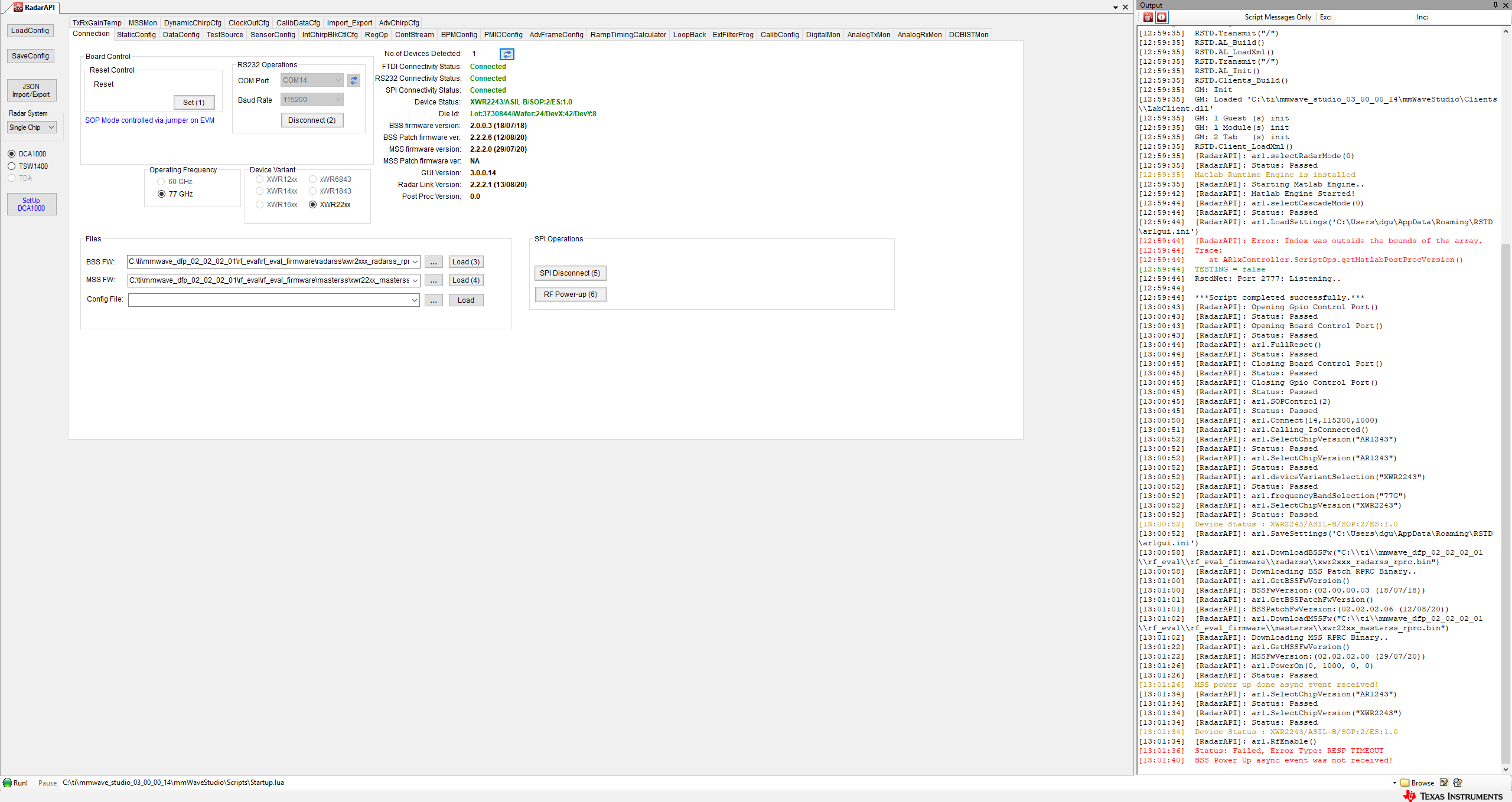

I have a problem with the AWR2243BOOST and DCA1000.
I followed the instructions on power-up by pressing: set, connect, then loading the BSS firmware and MSS firmware and SPI-connect.
Everything seems to be working smoothly until I press "RF power-up", then I get the "ar1.RfEnable() timeout" error message.
I have a screenshot of the configuration.

    [13:01:34] [RadarAPI]: ar1.RfEnable()
    [13:01:36] Status: Failed, Error Type: RESP TIMEOUT
    [13:01:40] BSS Power Up async event was not received!
  • Hello Daniel,
    The latest DFP 02_02_02_01 is targeted for AWR2243 ES1.1 devices (as mentioned in the release notes). From your screenshot and log, I can see that you have AWR2243 ES1.0 board.
    For your board, you can use DFP 02_02_00_03.
    Ishita
  • Thank you for your reply Ishita,
    I apologize for not noticing the difference, but this solved my problem.
    Thank you for such a rapid response.
