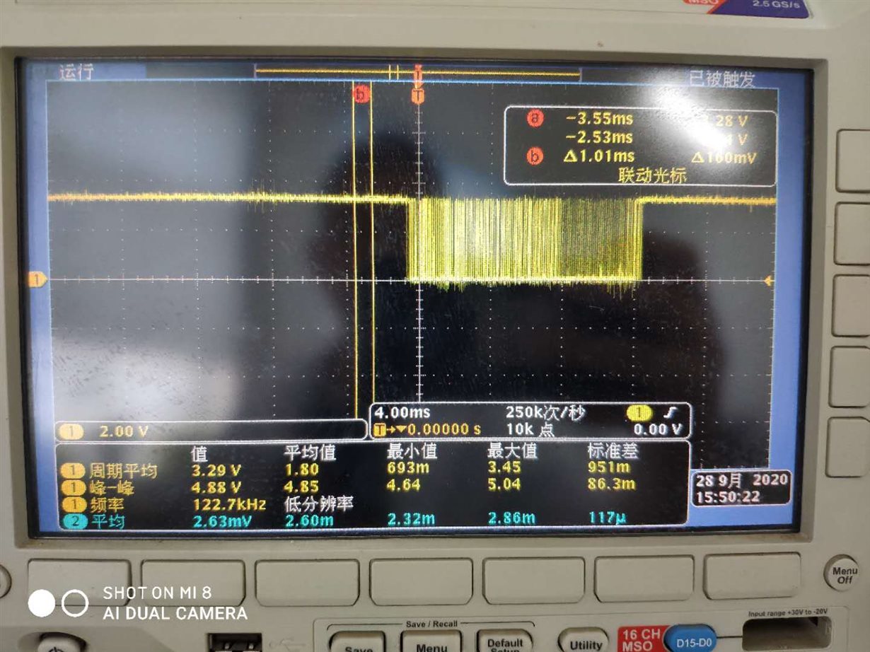

Thank you! The problem is resolved, but a new question arised, the PIN "AR_BSS_LOGGER" of EVM is:

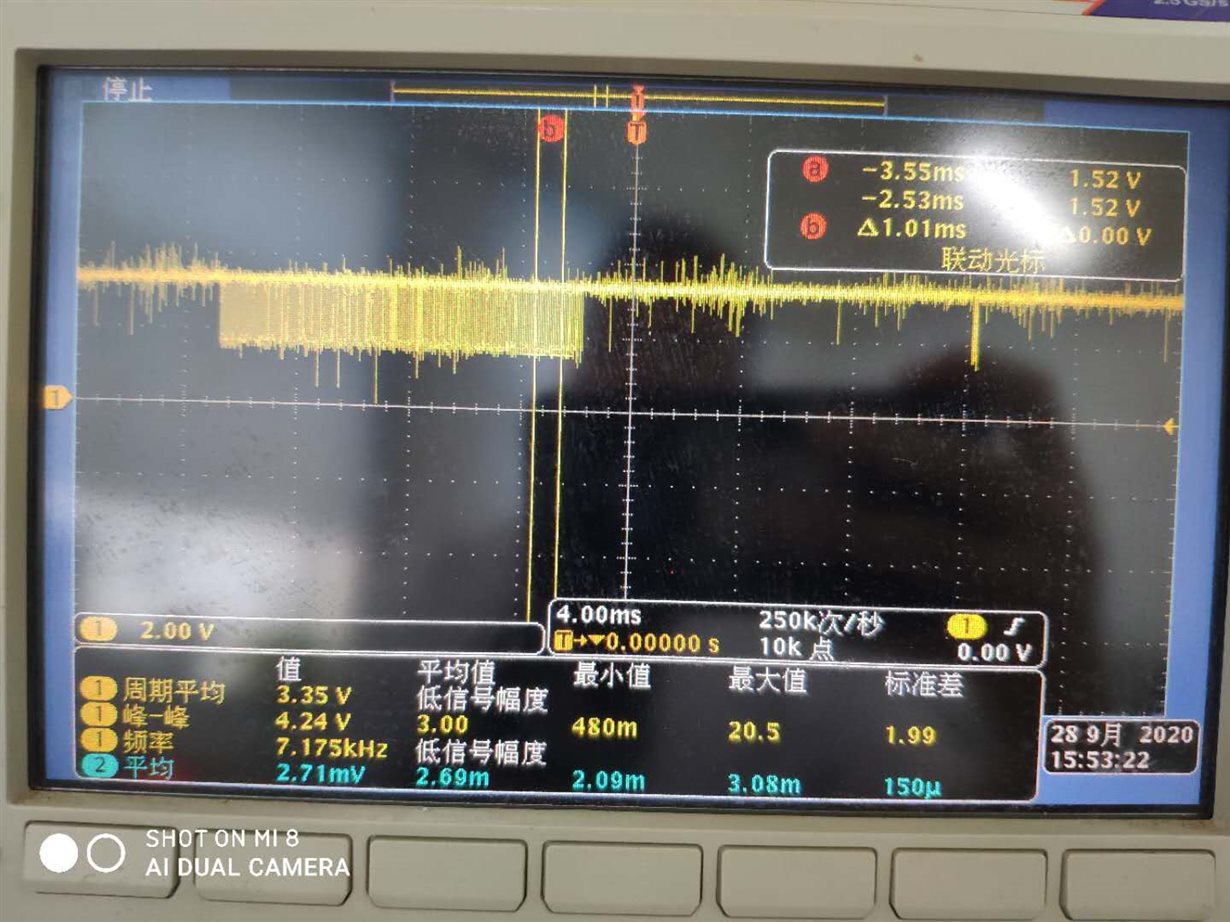

the PIN "AR_BSS_LOGGER" of my board is like this:
I want to know the reason,this is my board fileRADAR_V1.0.rar
Hello user4465796,
Thank you for the confirmation. Could you please provide information what was the problem?
Also, could you please post new post for the new question?
This would help other who has the similar problems...
