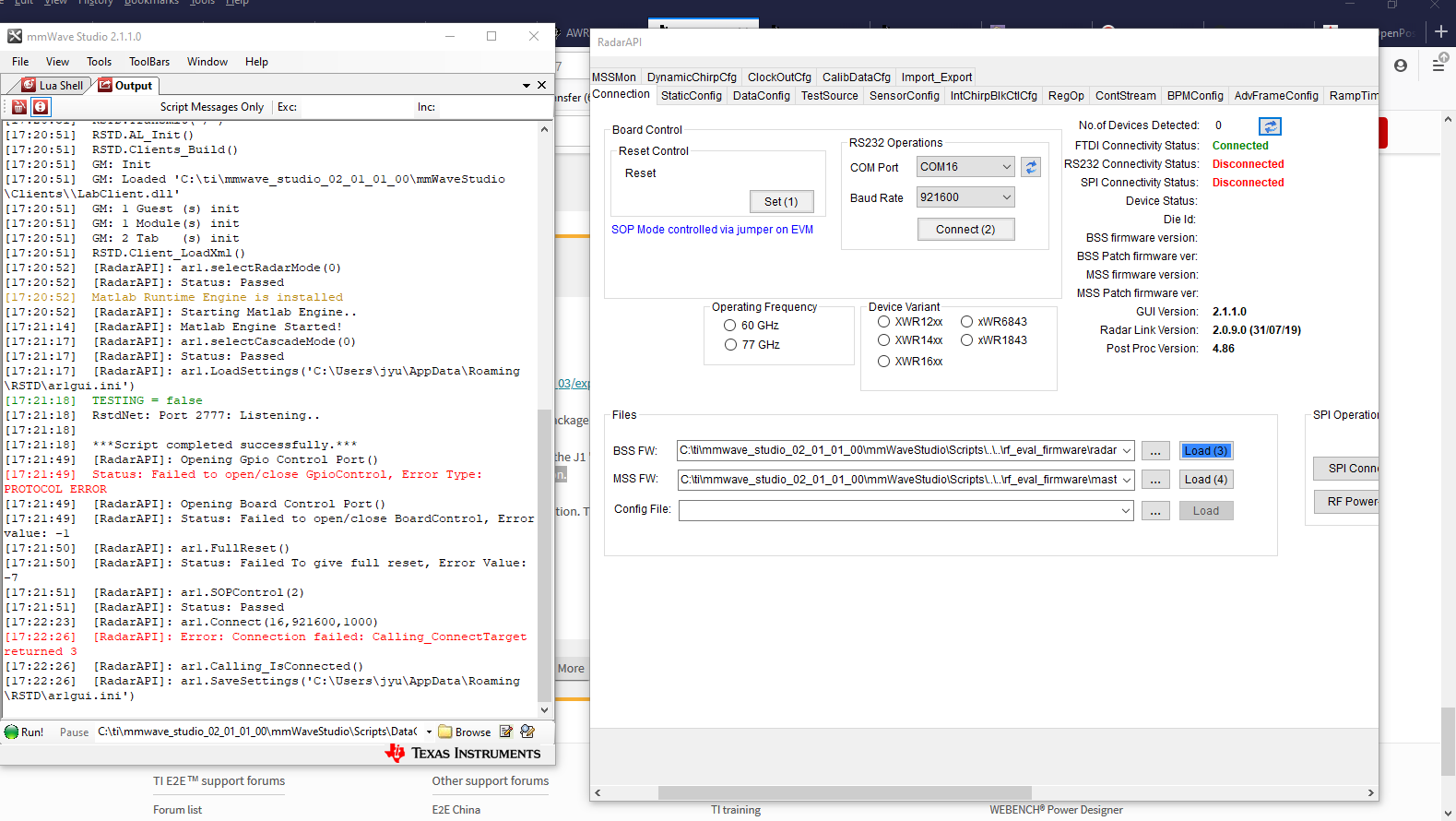

i follow the quick start (https://www.ti.com/lit/ml/spruik7/spruik7.pdf?ts=1600962267778&ref_url=https%253A%252F%252Fwww.ti.com%252Ftool%252FMMWAVE-STUDIO). to run demo code on  mmWave Studio 2.1.0 on AWR1243BOOST + DCA1000EVM.
Everything looks right except the  `SPI disconnection error` and I cannot pass through.  Anyone can help to check? Thanks.
Appendix:
1.  Hardware line-up (PASS)
2. Set static IP (PASS)
3. UART port (PASS)

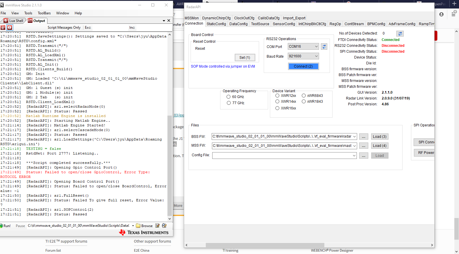

4. SPI disconnection (FAIL)
5. output (FAIL)

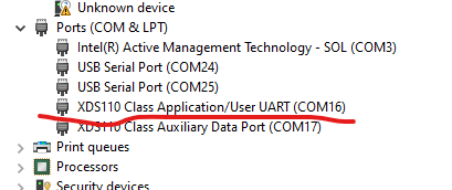

    I don't see the FTDI COM ports in the Device Manager
    Did you install the FTDI drivers on the PC?
    Thank you
    cesar
  • Thanks, It is correct I have NOT  install the FTDI driver. However, I find my installation (per the user maunal 2.3 User interfaces and drivers) FAIL for some reason, Could you help to check on that as well?

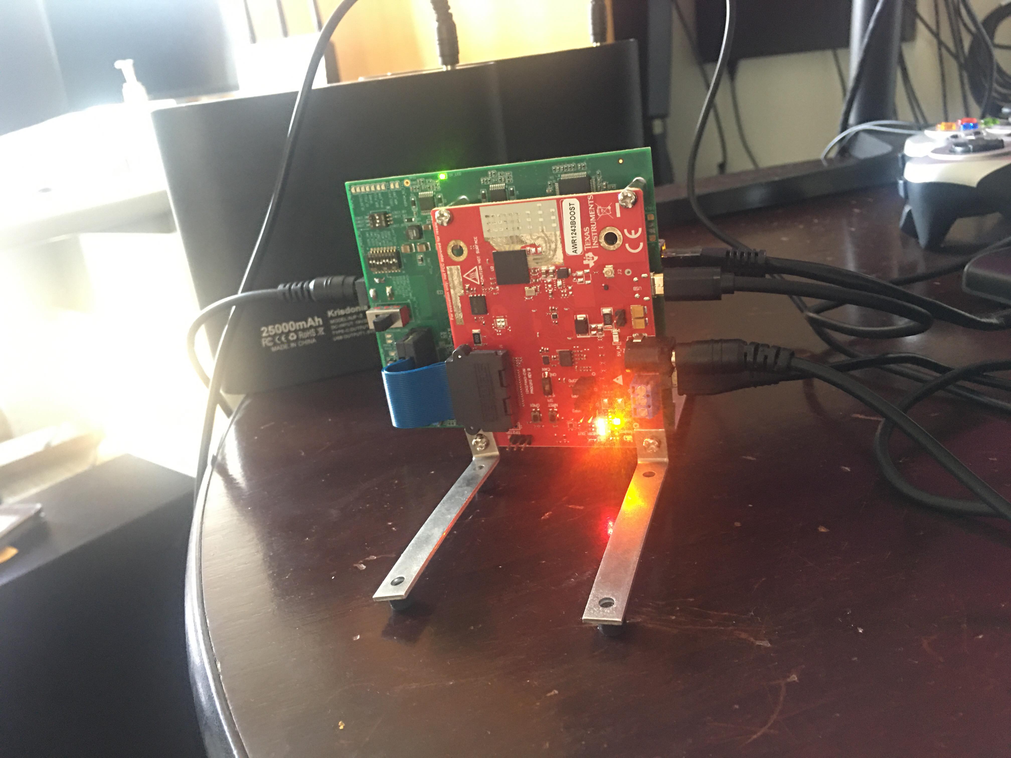

    Make sure the USB cable from your PC to the DCA1000 is connected to the J1 "RADAR_FTDI" port. Consider providing a separate power supply just to the DCA1000 and set the power switch to the "DC_JACK_5V_IN" position.

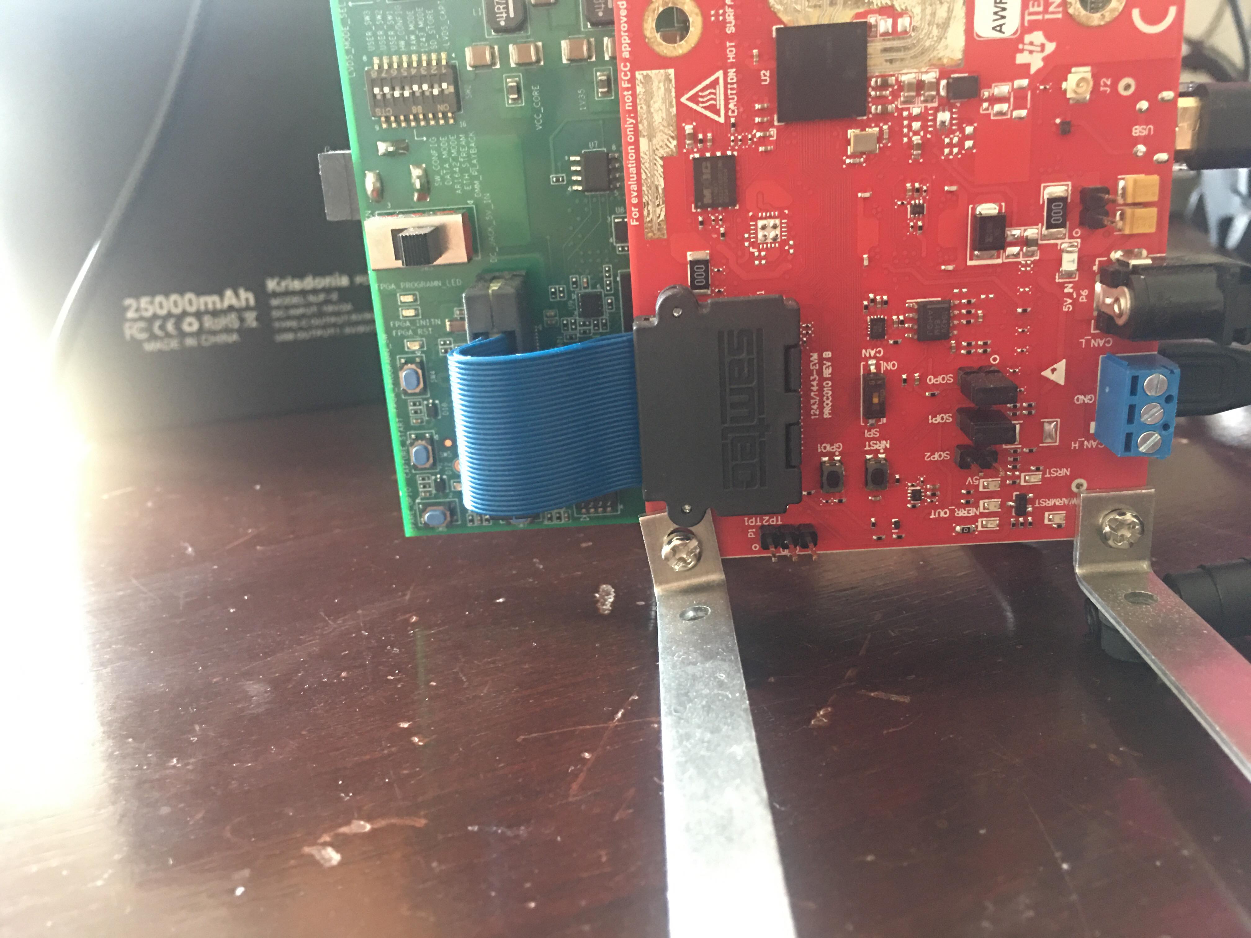

    On the BOOST EVM, make sure the CAN/SPI switch is set to the SPI position. This is found just to the right of the 60-pin connector.

    2. I check the  (a) J1 "RADAR_FTDI" port   (b) "DC_JACK_5V_IN" switch (c) CAN/SPI switch is set to the SPI and it work as your expect.

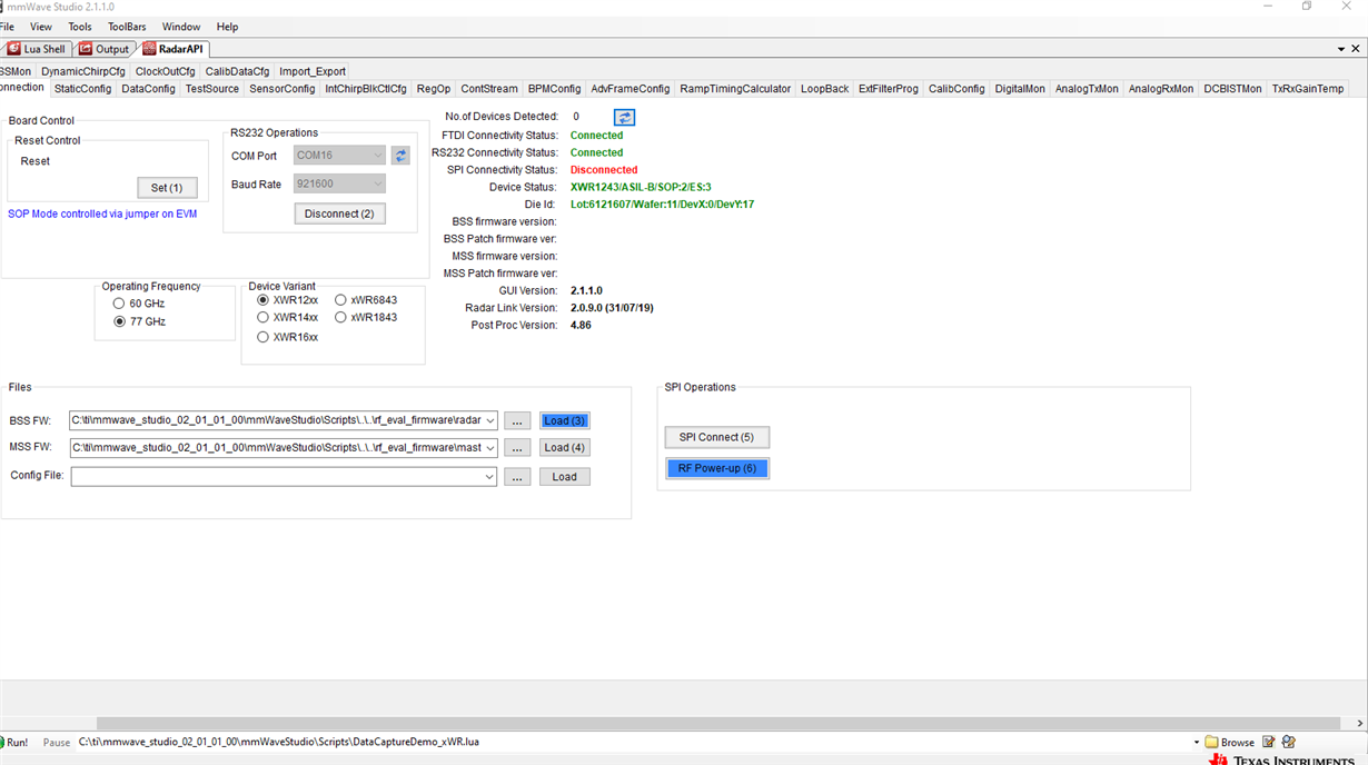

    Appendix:
    1. step 1 'Set' FAIL
    2. step 2 'Connect' FAIL
    Number of devices detected shows 0. Can you check your FTDI driver is installed correctly and shows up in Device Manager
