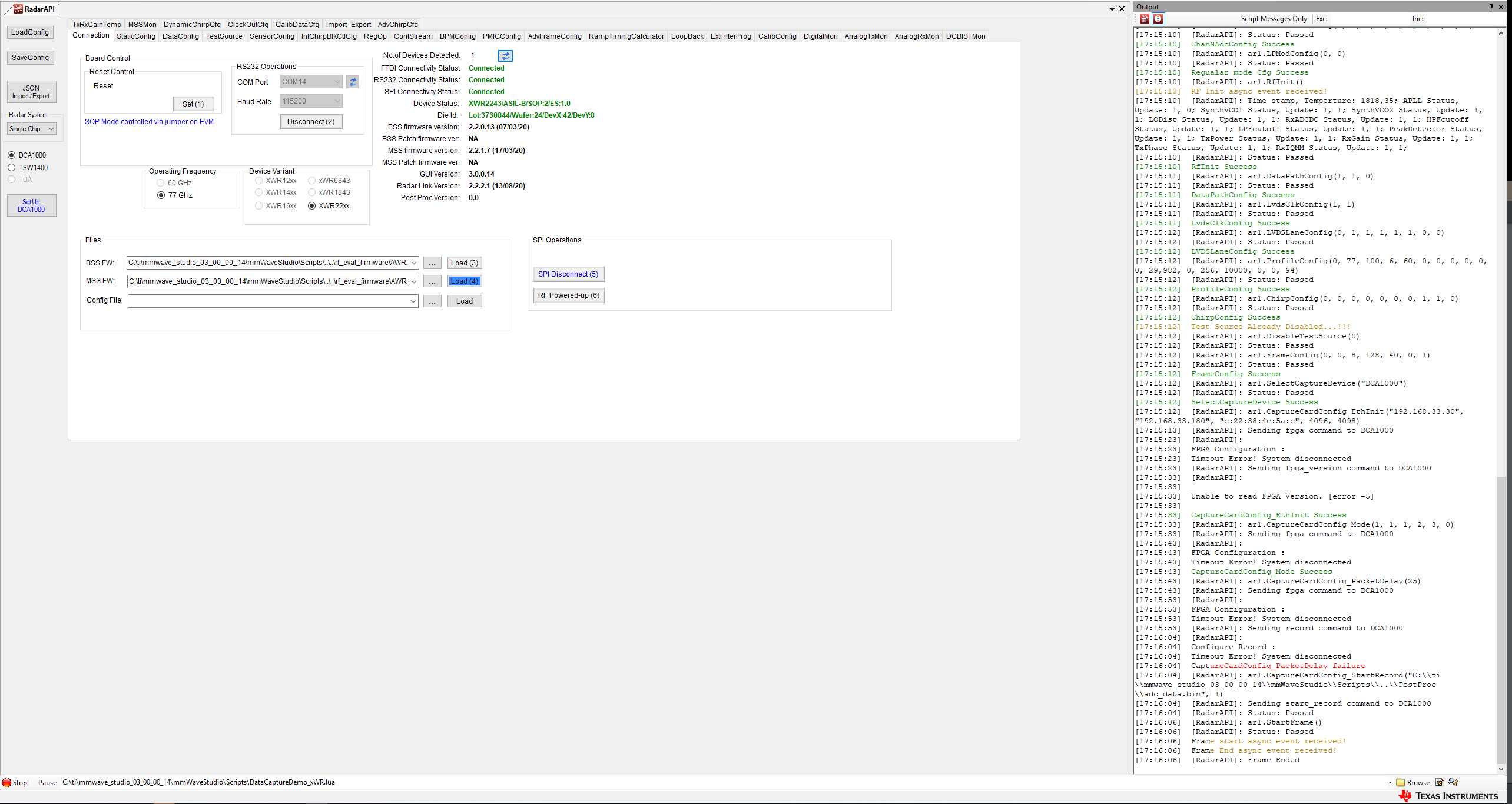

I cannot seem to get contact with the DCA1000EVM.
I am following the guide at https://www.ti.com/lit/ml/spruik7/spruik7.pdf
The PC is connected via 2 USB cables (one to each board) and directly to the ethernet connector of the DCA1000EVM.
I simply reset the board, connected and run the script "DataCaptureDemo_xWR.lua"
Configuration info:
The error printout is like this:

[17:15:12] [RadarAPI]: ar1.CaptureCardConfig_EthInit("192.168.33.30", "192.168.33.180", "c:22:38:4e:5a:c", 4096, 4098)
[17:15:13] [RadarAPI]: Sending fpga command to DCA1000
[17:15:23] [RadarAPI]:
[17:15:23] FPGA Configuration :
[17:15:23] Timeout Error! System disconnected
[17:15:23] [RadarAPI]: Sending fpga_version command to DCA1000
[17:15:33] [RadarAPI]:
[17:15:33]
[17:15:33] Unable to read FPGA Version. [error -5]
[17:15:33]
[17:15:33] CaptureCardConfig_EthInit Success
[17:15:33] [RadarAPI]: ar1.CaptureCardConfig_Mode(1, 1, 1, 2, 3, 0)
[17:15:33] [RadarAPI]: Sending fpga command to DCA1000
[17:15:43] [RadarAPI]:
[17:15:43] FPGA Configuration :
[17:15:43] Timeout Error! System disconnected
[17:15:43] CaptureCardConfig_Mode Success
[17:15:43] [RadarAPI]: ar1.CaptureCardConfig_PacketDelay(25)
[17:15:43] [RadarAPI]: Sending fpga command to DCA1000
[17:15:53] [RadarAPI]:
[17:15:53] FPGA Configuration :
[17:15:53] Timeout Error! System disconnected
[17:15:53] [RadarAPI]: Sending record command to DCA1000
[17:16:04] [RadarAPI]:
[17:16:04] Configure Record :
[17:16:04] Timeout Error! System disconnected
[17:16:04] CaptureCardConfig_PacketDelay failure
[17:16:04] [RadarAPI]: ar1.CaptureCardConfig_StartRecord("C:\\ti\\mmwave_studio_03_00_00_14\\mmWaveStudio\\Scripts\\..\\PostProc\\adc_data.bin", 1)
[17:16:04] [RadarAPI]: Sending start_record command to DCA1000
[17:16:04] [RadarAPI]: Status: Passed
[17:16:06] [RadarAPI]: ar1.StartFrame()
[17:16:06] [RadarAPI]: Status: Passed
[17:16:06] Frame start async event received!
[17:16:06] Frame End async event received!
[17:16:06] [RadarAPI]: Frame Ended
[17:16:11] Please wait for a few seconds for matlab post processing .....!!!!
[17:16:11] [RadarAPI]: ar1.StartMatlabPostProc("C:\\ti\\mmwave_studio_03_00_00_14\\mmWaveStudio\\Scripts\\..\\PostProc\\adc_data.bin")
[17:16:11] [RadarAPI]: No of files Captured: 0, Total no of frames for each device : 8
[17:16:11] Error : The number of files captured is zero!
[17:16:21]
[17:16:21] ***Script completed successfully.***
It seems that the issue is the connection to the DCA1000
Could you please try a different ethernet cable?
thank you
Cesar
Also, make sure the second USB cable is connected to the FTDI connection port on the DCA1000EVM.
Kyle
The problem was that the ports were blocked by the firewall.
Thank you for your feedback.
Daniel
