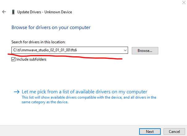

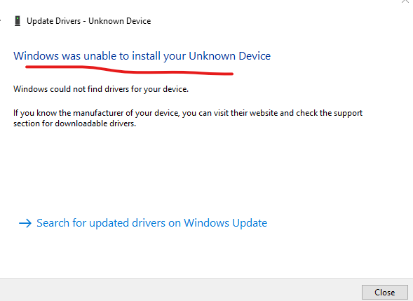

I have FAIL to install the FTDI driver when running demo code on mmW Studio with AWR1443BOOST orAWR1243BOOST . However, I find my installation (per the user maunal 2.3 User interfaces and drivers) FAIL for some reason, especially Window Update would not pass, Could you help to check on that?
Appendix
0. I have installed XDS Emulation Software (EMUPack) already.
1. update driver via device manager
2. be told installation FAIL

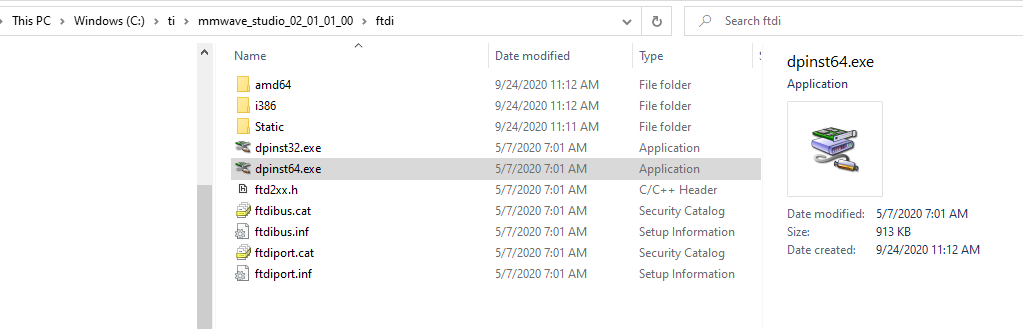

3. the folder, i have install dpinst64.exe
6. after restarted Window PC, still not recognized

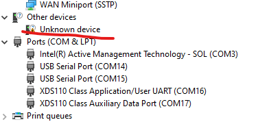

    A quick question regarding this, for which USB port are you updating the FTDI drivers? After connecting the DCA1000 board (or mmWave DevPack), do you see some unrecognized USB serial ports in the device manager? It is those serial ports for which you've to update the drivers.

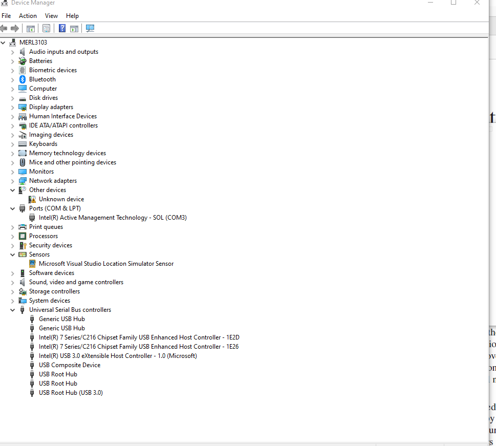

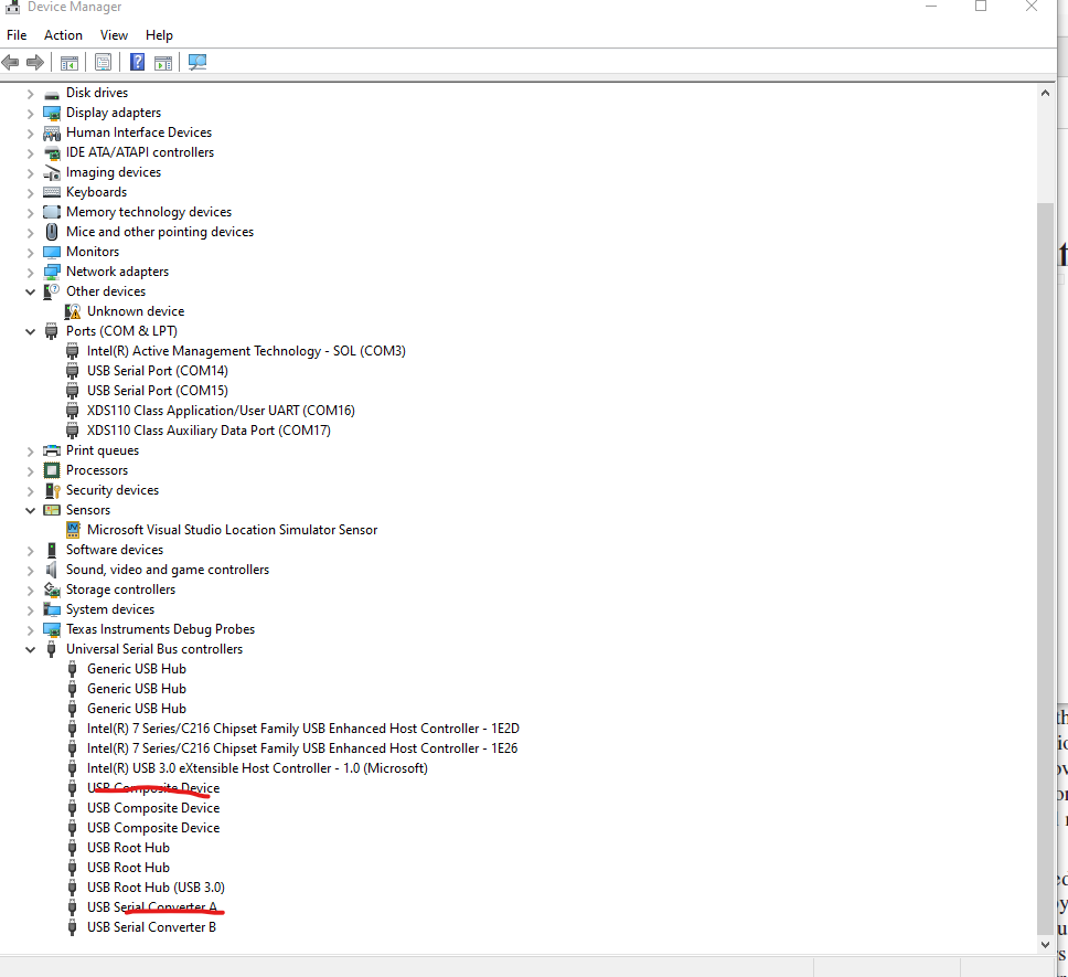

    Thanks for the kind reply. I check the listed changes before and after I insert the USB cable (I am using a USB hub connection DCA1000 USB, ethernet port and AWR1243 USB).
    1. before connection
    2. after connect usb
    We can see there are more port under "Universal Serial Port controller" .... while the "unknown device" exist early before I connect the USB cable. I feel like I should not update the "unknown device". Could you tell which port and step I should work on. Thanks.
  • Hello Jianyuan,
    It is recommended to connect the AWR and DCA1000 EVM directly to the PC and not use any passive USB hub. And yes, you don't have to update the drivers for the "unknown device", it will only work in case of the DCA serial ports.
    Ishita
