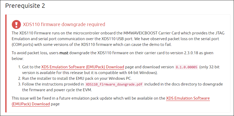

      Thanks for your suggestion. We found the strange point is always happen in the bytes 193. We think it maybe a ringing buffer issue. Could you tell us what's the buffer size of UART? Is it possible enlarge the buffer size of UART?
    Thanks.
    C.W.
    As a first step, have you followed pre-requisite 2 as given in the overhead demo user guide in the beginning? If not, please make sure you follow these steps to downgrade the XDS110 firmware. Let us know if you still see the data loss.
    -Nitin
