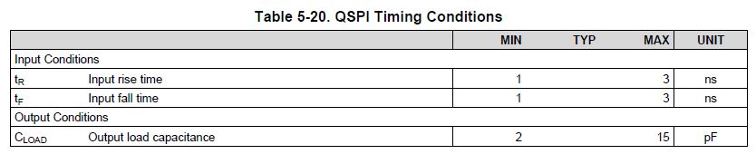

In AWR1642 datasheet, you can find below info.
I think the input conditions is for input signals for QSPI interface of AWR1642. Is it right?
If yes, then the data lines of QSPI can be input signals. Why there is min for the input rise/fall time?  We suppose that the faster the signal from low to high or high to low, the better.
