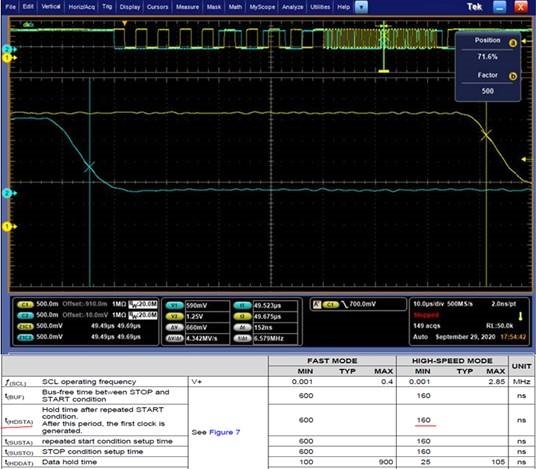

the customer found lower than spec problem during I2C set up time measure.
the measured value is 152n sec, spec min is the 160n sec.
can TMP102 accept this result?

Tommy -
They would break with the I2C spec if that was the case. I would encourage the customer here to either use MCU/MPU/Controller that follows I2C spec. TI and many other companies make such devices from them to choose from.
