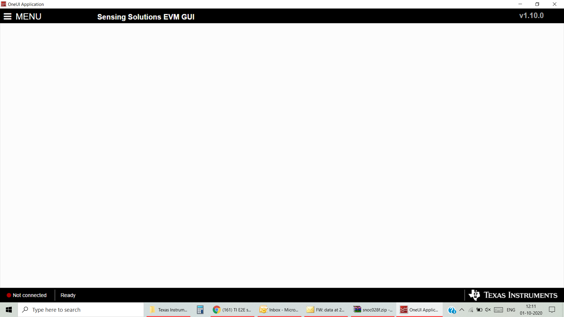

Hi, I have a problem with the Sensing Solution EMV GUI, as it cannot detect the   EVM board when I power these board red led blinking for 5 sec. I have checked the device manager, both USB and PORT work well. But there is no connection between GUI and EVM.
  • Shivam,
    I would recommend checking the I2C connections. I believe that the blinking red LED indicates a problem communicating with the device. Perhaps check SD,ADDR, SDA, and SCL on either side of the J3 socket to ensure lines are not broken and operating as intended.
    Please check that the install instructions were followed as detailed here:
    https://www.ti.com/lit/ug/snou135a/snou135a.pdf
    Additionally, please try to right click and run as administrator when launching the GUI.  This will sometimes help with connectivity issues.
