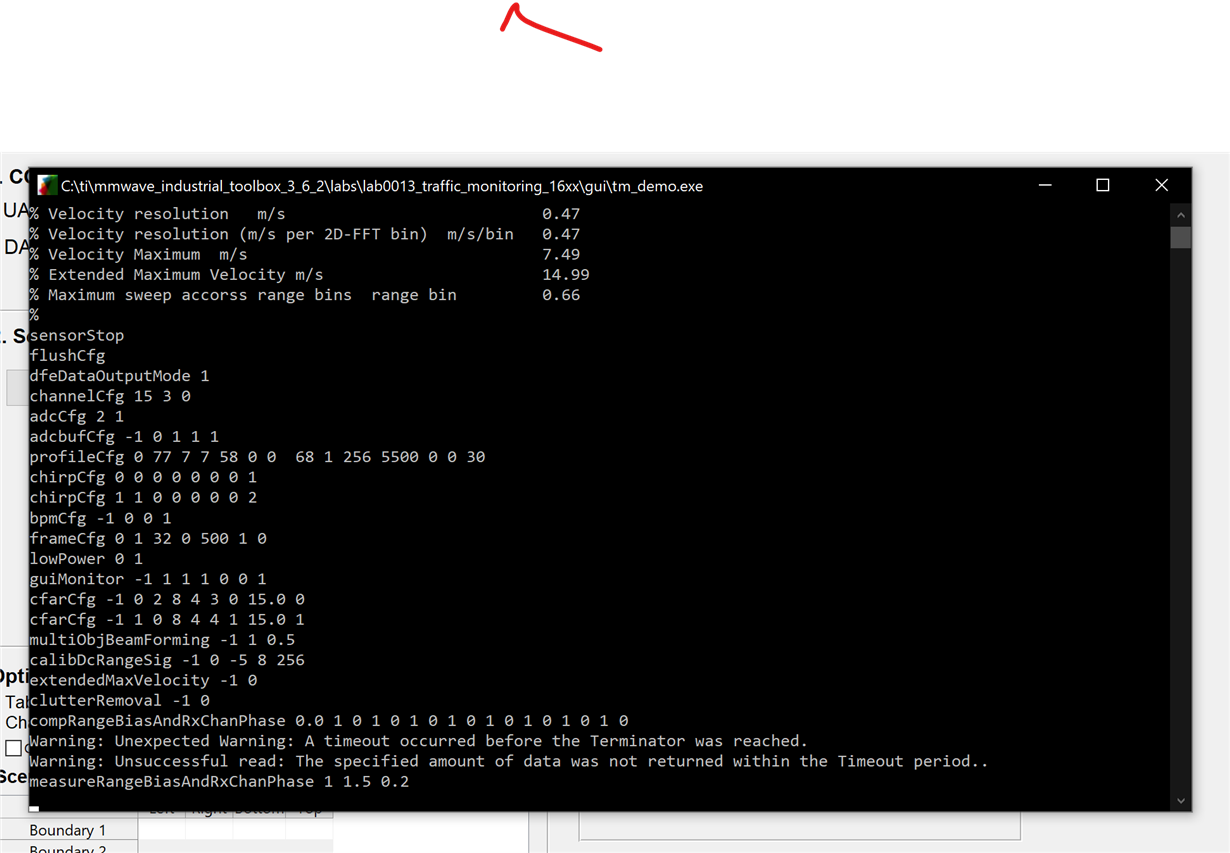

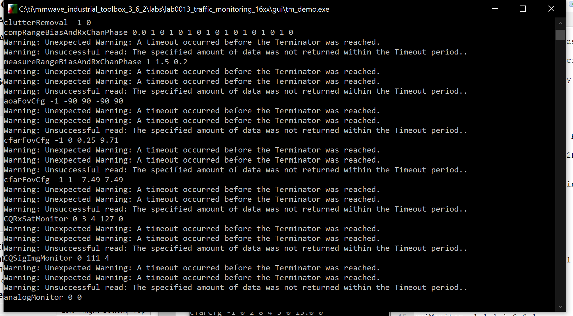

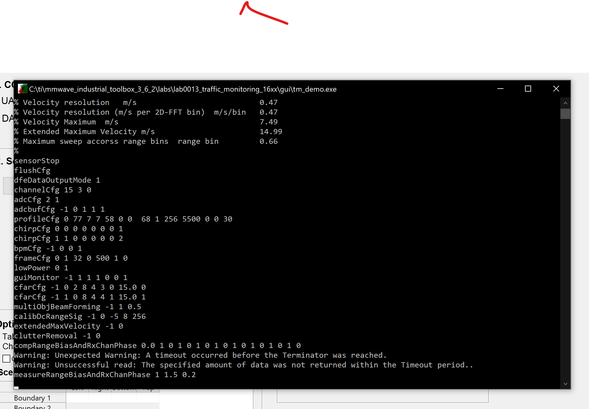

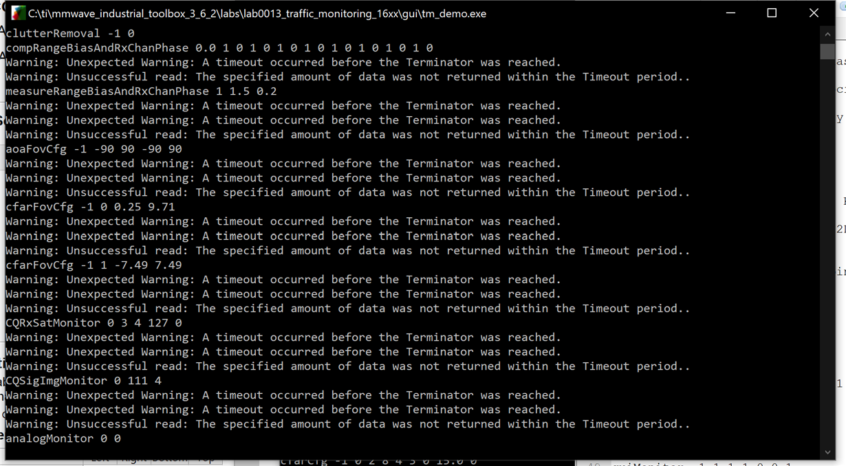

  • Thank you very much for your help! I have another question, I've installed the industrial toolbox 3.6.2 now and have been following the user's guide steps for setup. I am up to the section "configure visualizer" where it says I should perform calibration following the "range bias and Rx channel gain/offset measurement and compensation section". So in following that section of the index.html file I have:
    - Setup a strong target (A corner reflector) at X = 1.5 metres from the target placed on the ground (with the IWR1642 also on the ground facing the target)
    - Opened profile_calibration.cfg and changed the line to 'compRangeBiasAndRxChanPhase 1 1.5 0.2'
    - Then using the TM_demo.exe in the lab0013_traffic_monitoring_16xx GUI folder, have setup the COM ports, browsed and added the above mentioned cfg file
    And as a result have gotten the following outputs below, where have I gone wrong?
  • Just to save time also I have seen this thread and have both removed my SOP2 jumper and my board has 502AC chip meaning it is ES 2.0?
  • Former Member
    0 Former Member in reply to Jake Rice
    For the calibration you should have the mmWave SDK demo binary flashed + use the profile provided in the SDK for calibration and make the changes to the cfg. Then use the online visualizer to load the cfg and see the calibration results.
    Then copy one of the calibration results into the cfg for the TM demo.
    You shouldn't be using the TM cfg or TM visualizer binary to get the calibration info.
