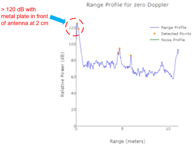

    The plot below shows the relative power on a range profile plot I captured using mmWave Demo Visualizer when a copper plate of 3 cm x 3 cm was placed directly in front of the radar's antenna array at 2 cm separation. As you can see, the relative power at around 0 meters range (which is the metal plate in front of the antenna basically) exceeds 120 dB mark. I am not sure how this is related to the 10 dBm receiver limitation you mentioned in your previous message. Can you please elaborate on the relationship between this relative power and the received power you talked about?
    Another related question I have is there a tool that will tell me the received power on the radar directly in real-time (similar to mmWave Demo visualizer)? If there is a simple way to calculate the actual received power in dB using the visualizer's relative power that would also help. I just want to make sure that I stick to sub 10 dBm receive power limit you mentioned in order not to damage AWR1642 BOOST board.

  • Hello Cagri,
    You cannot convert the 120dB number directly to the dBm value on Rx input since this is within the HPF region. But I don't think you need to worry about damaging the device as such since the Tx o/p itself is 11-12 dBm . So the reflection from the metal plat cannot cross the 10dBm value on the Rx input.
    While we don't see any risk of damaging the device you would be aware that keeping a metal plate in front of the antenna would prevent detection of any object beyond the metal plate. So what is the intended use case and what are you trying to measure?

    Is there a tool that can report on the received power in terms of dBm? What is the best way of calculating the received power using the captured *.dat files from the mmWave Demo visualizer (if any)? If there is documentation you suggest I look up for this, that would be really helpful for me.
    I am aware that such an arrangement will prevent object detection by the radar and I am using this phenomenon as a feature in a set of experiments I am designing at the moment.
    Cagri
  • Hello Cagri,
    We do not have any tool that would directly provide the dbm value at the LNA input. you an refer to the following e2e thread to calculate it using the ADC code peak amplitude : e2e.ti.com/.../916374.
    Additionally you need to account for the HPF filtering since your object is very close and it will fall within the HPF region. We have two HPFs, each a single pole. Hence each of them will provide 20dB attenuation per decade from the cut off frequency you are programming. Add this attenuation values to the ADC dBFS value before converting it to dBm.
