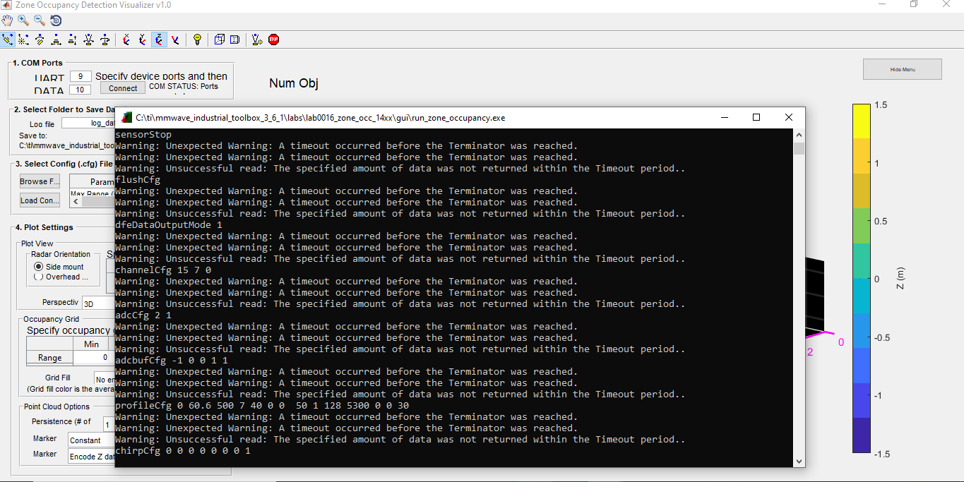

I am using IWR6843ISK-ODS for the Human Fall and Stance Experiment.
I have followed the document from industrial toolbox 3.6.1. As per that,
1. Flashed the binary from lab0025.
2. Executed the GUI(run_zone_application) from lab0016.
3. Given the profile configuration from lab0025.
In the console, after each command of the configuration file, the following prompt is shown(Attached the Image for reference).
