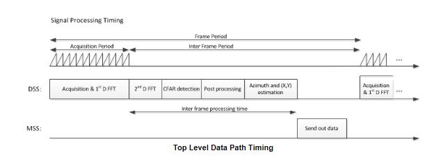

    I also want to know  what is 1 frame of data in CCS? Is it equal a mmWave's period?
    Question:
    Answer:
    The frame is the data unit used by a mmWave sensor The duration of the frame is configured by the user. During a Frame there is an Acquisition Period when the ADC data is received and an Inter Frame Period when the data is processed.
