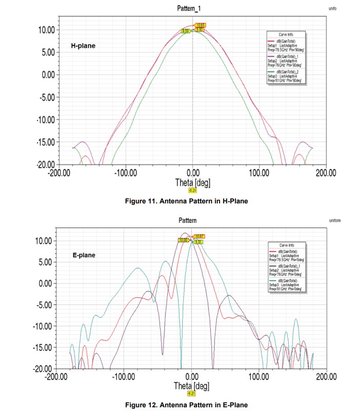

I have been using several IWR1443BOOST + DCA1000EVM boards. Could you please let me know the azimuth and elevation beamwidth of the IWR1443BOOST module?
As per the notes here https://e2e.ti.com/support/sensors/f/1023/t/718713, I found the beamwidth in degrees, but could not find the document that was mentioned in the response.
Also, could you please let me know if we can get the beam radiation pattern of the antenna?
