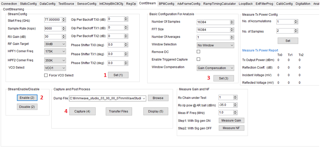

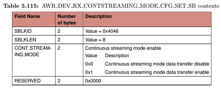

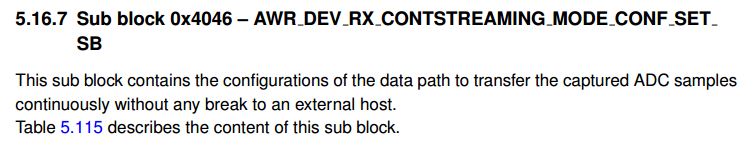

I want to know how to implement the sub block AWR DEV RX CONTSTREAMING MODE CONF SET SB (which is mentioned in mmWave-Interface-Control : AWR DEV CONF SET MSG) on MMW STUDIO? I didn't find that.
Junzhe
  • Hello Junzhe,
    There's a tab in mmWave studio called as "ContStream" for this purpose. I have highlighted the steps for your reference (see below).
    Furthermore, you could also refer to the example script "DataCaptureDemo_xWR.lua" we provide as a part of mmWave Studio package for this. Just enable the required setting for Continuous stream mode and you're good to go. You can find the script at the below location:
    <Install_directory>\ti\mmwave_studio_<version>\mmWaveStudio\Scripts
    Let us know if you have any more queries.

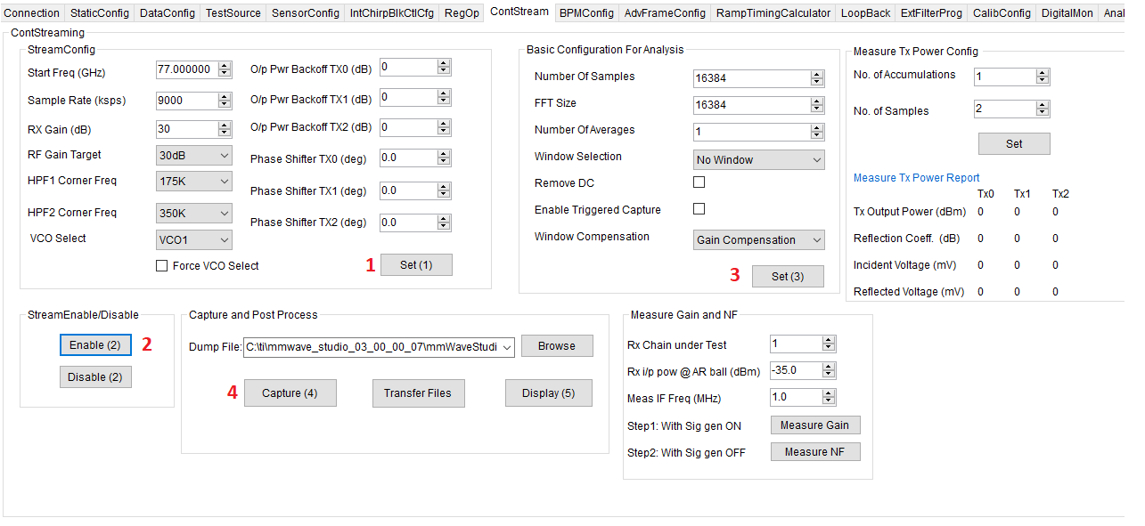

  • Hi Ishita,
    Thank you for your reply!
    I've tried the "ContStream" tab in MMW-STUDIO. Once I made it enable , the chip's temperature becomed very high, I mean it was hot to touch . And I couldn't get the LVDS frame clock as well.

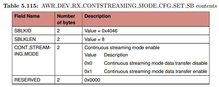

    But I have another AWR1243BOOST, I configured it by transfering messages mentioned in mmWave-Interface-Control via SPI. And I just set the sub block AWR DEV RX CONTSTREAMING MODE CONF SET SB without setting anyother SBs of contsreaming in AWR RF DYNAMIC CONF SET MSG. Then I could get the LVDS frame clock ,and the chip's temperature was normal.
    I just can't implement this SPI message sub block AWR DEV RX CONTSTREAMING MODE CONF SET SB on MMW-STUDIO. I want the data path to transfer the captured ADC samples continuously without any break to an external host so I can capture the LVDS frame clock. I don't want to using the continuous wave function.
