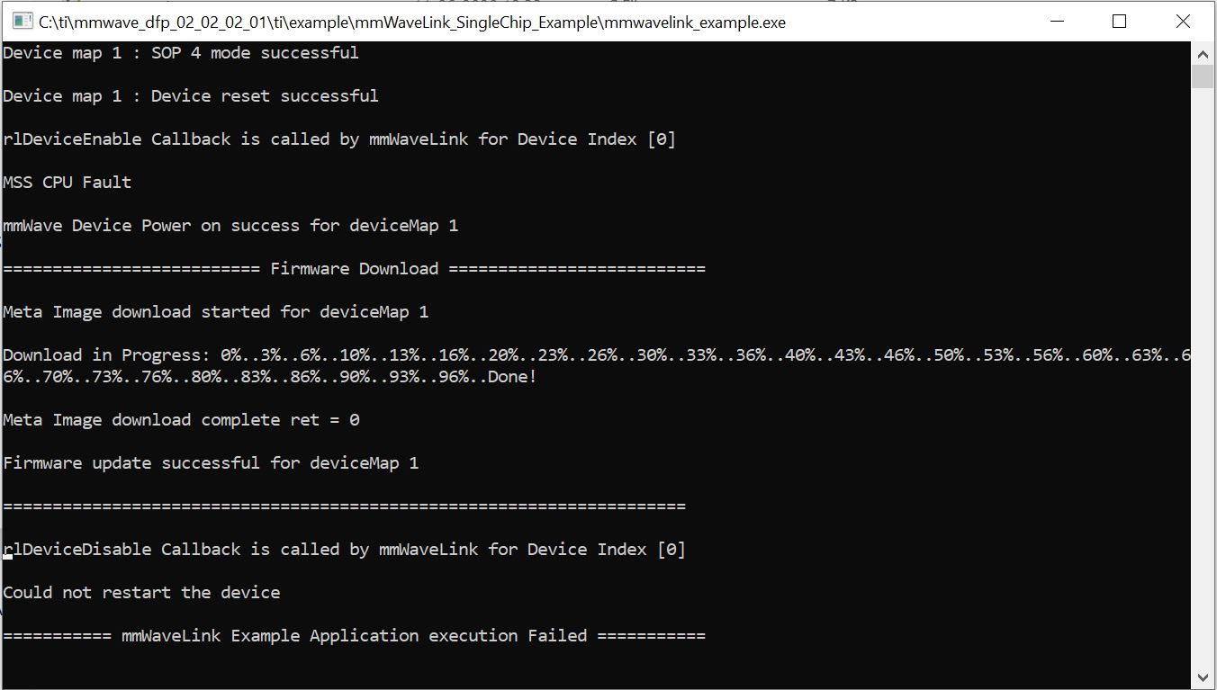

  • Hello Ishita,
    This is the error I receive.  MSS CPU Fault and Could not reset the device
    Mohan Sunderam

  • Hello Mohan,
    Please refer to some suggestions below:
    1. For the DCA1000 CLI tool details, please refer to section 7 of the mmWave_DFP_user_guide.pdf that comes as a part of the DFP Package (docs folder). The tool is a part of mmWave Sudio.
    2. I see you're using DFP 02_02_02_01. This package is specifically for AWR2243 ES1.1 devices. In case you have AWR2243 ES1.0, please use the DFP package compatible with your device. You can check the package release notes for that.
    3. MSS CPU fault error is a known issue in AWR2243 1.0 devices during boot up. It won't affect any device functionality, and you can proceed further with your testing.
    4. Now regarding the error you're getting, I recommend you to first ensure if you're using the correct firmware, then let me know if you're getting any error with that.
    Ishita
  • Hello Ishita,
                    Thank you for the info on the dfp. I changed the DFP im using from mmwave_dfp_02_02_02_01 to mmwave_dfp_02_01_05_03 and I am able to connect to the AWR 2243 boost board but I still dont see any data in adc_data(the data doest gets over writtern from previous measurement done from mmWave studio ). I get the DCA1000EVM_CLI_Control.exe and DCA1000EVM_CLI_Record.exe application to sucess command on the command line. But dont see the data in the .bin file.
    Also just out of curiousity what is this MSS CPU fault and why does it pop up.

  • Hello Mohan,
    So you're not getting any error as such with DFP 02_01_05_03? Just not getting the data in the bin file, is that correct? Let me also try this at my end with the same DFP and I'll get back to you latest by tomorrow.
    Regarding the MSS CPU Fault error, it comes during bootup due to a register read-back failure in AWR2243 ES1.0 devices, but as I said, it wont affect any functionality.
    Ishita

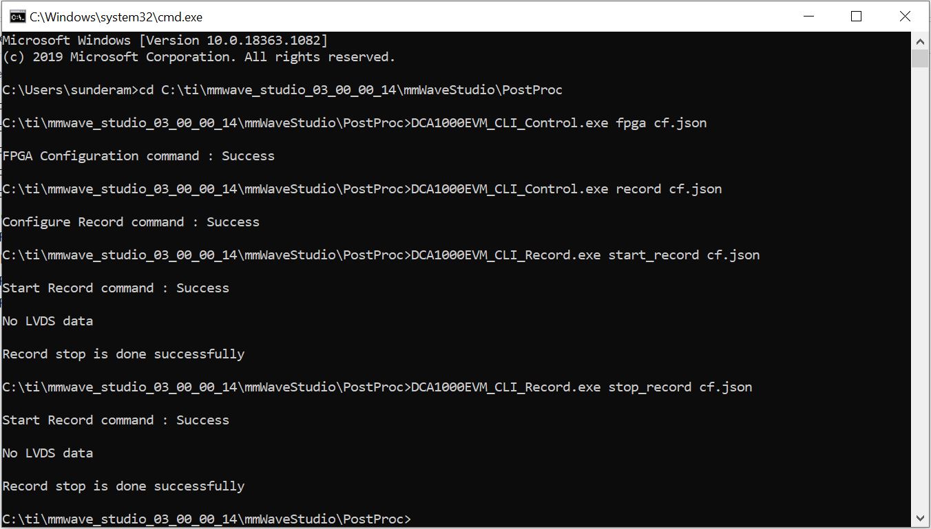

  • Hello Ishita,
                  So I tried the following as suggested by you.
    1. Connected the AWR 2243 through mmWave studio 3.0.0.14
    2. Set all the required parameters
    3. Connected to DCA 1000 EVM board through mmWave studio
    4. Through cmd line commands tried to get the data from DCA 1000
    I still dont get any data: No LVDS data captured is the message (see image). So is it safe to assume that the CLI is the issue ?
    Mohan

  • Ishita,
     I already did that.
    With mmwave studio everything works well. But with the CLI tool I dont get anydata.
    I already flashed the latest FPGA firmaware using the Lattice Diamond flashing tool.
    Looking forward to your guidance about the same.
    Mohan Sunderam
  • Hello Mohan,
    The JSON file which the CLI uses as input is same for the mmWaveStudio use case and the DCA1000 stand-alone use case.
    Please check for the following:
    1. Once the start_record command is given, wait for one-two seconds for a temporary CLI to open up in the background which indicates that the process is ready to capture. At this point of time, trigger the frames. Once the frames has ended, within a second or two, the temporary CLI closes back again. This indicates that the capture was successful. Else, even before the start record process has started and if the frames are triggered, the DCA1000 won’t be capturing anything and it results in the NO_LVDS_DATA_RECEIVED command.
    2. Check your json file as well and make sure all parameters are correct.
    You can view the csv file which displays the stats of the capture and the corresponding bin file. There is also a file called CLI_LogFile.txt which gets created for every command that is sent through the CLI. (for debugging purposes)
    Please try and let us know.
    Ishita

  • Also can you attach the trace file you got when the example was succesful for reference.
    Thank you in advance
  • Hello Mohan,
    Here is the trace file I got with my experiment : 2134.trace.txt
    Let me study your config and trace file, and I will get back to you in a day or two.
    Ishita
  • Hello Ishita,
     As far as I have checked the traces files, both of them look pretty similar.
    Maybe you can share more details soon.
    With best regards,
    Mohan
  • Hello Mohan,
    For now you can change the crc value as "1" i.e. 32 bit in the mmwaveconfig.txt file and proceed ahead with your experiment.
    Ishita
  • Hello Ishita,
                    I tried with changing the CRC value to 1 and it still doesnt work. I hope you have had time to perform more measurements and hence have more inputs for me.
    Mohan Sunderam
  • Hello Mohan,
    In addition to the CRC value, please keep lpAdcMode=0.
    Sorry, I forgot to mention this earlier.
    Ishita
  • Hello Ishita,
    I will try and let you know whether this works for me.
    best regards,
    Mohan
  • Hello Ishita,
     I tried changing the said parameters and also with the right SOP mode(4). I get the same mmWave device error -8.
    Can you please check this issue for me.
    Mohan
  • Hello Mohan,
    I remember previously you were getting a BSS CPU fault error before RF INIT. I was getting the same error when I tried with your mmWaveconfig.txt file, but it was resolved with the above mentioned two changes.
    Now when are you getting this error code -8? It seems this time its a connection issue.
    Ishita
