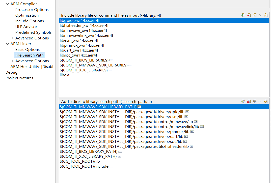

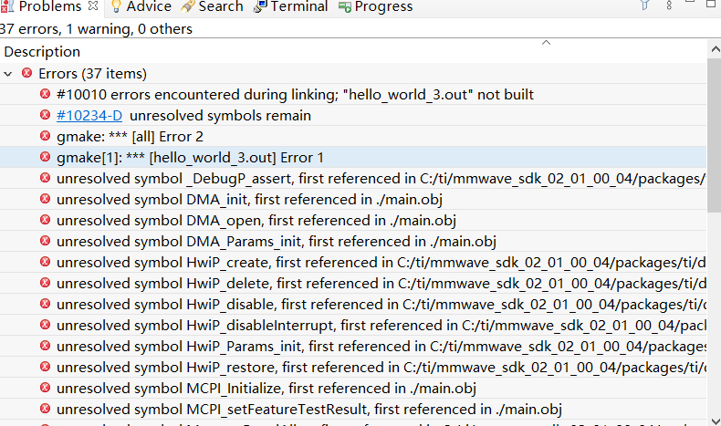

I am trying to build CCS project to run mmwave SDK drivers. The index.html of each driver doesn’t show how to set the proper environment of CCS. I have referenced the project of vital sign, but I have encountered many “unresolved symbols” errors. My project include,file search path are shown below.
Please tell me how to use sdk drivers in CCS project, thank you!
  • Hello Gaoyang,
    Did you take a look at our SDK FAQ page? This query has been addressed there. We request you try some workaround mentioned for this. Below is the page produced for your reference:
    Please take a look at Q15.
    Hope this helps, let us know if you need more info.
