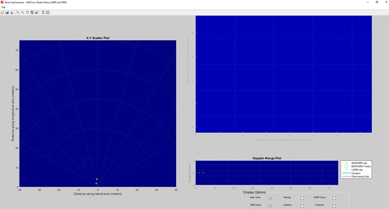

Hi, I am running the beam steering lab but the Y-Z plot does not shows anything and I have an obstacle at 3m in front of radar and has 2m of height , is this normal?, I have not modified any line of code of the lab

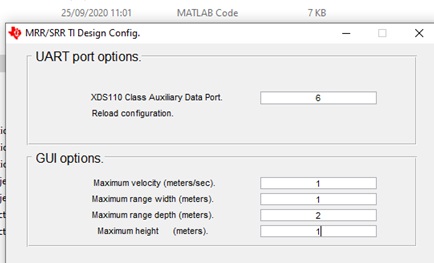

GUI settings:
I also tried to change the GUI display settings to get a zoom of the area when I am working but the results are the same
  • Hello Jairo,
    Make sure that you have flashed the prebuilt binary file from the MRR Beamforming lab from TI-Rex to AWR1843BOOST.
    Default binary should work without any issue, even GUI should plot the object data on all the screen blocks.
    Jitendra
