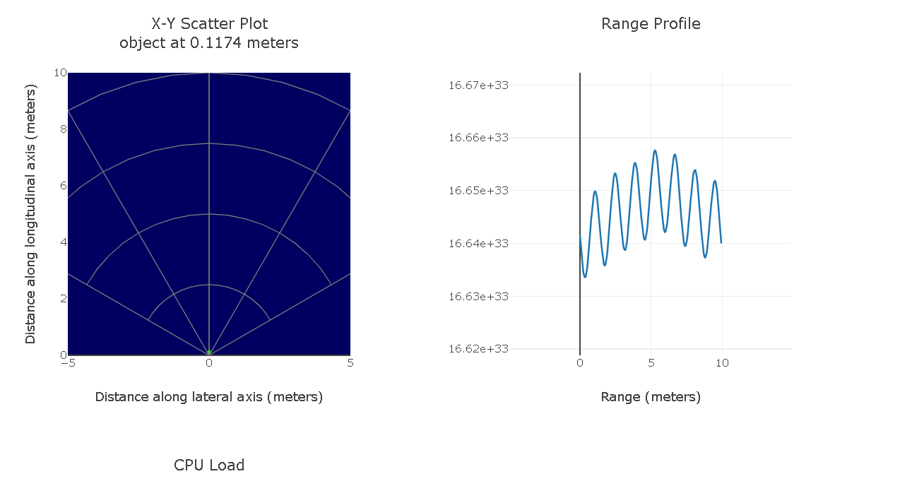

I have ported high accuracy level sensing lab from IWR1642 to IWR1843. And using High_Accuracy_Visualizer to check the result. It works fine with the default chirp config which is provided from the mmwave_industrial_toolbox_4_2_0.
Then I try to modified the chirp config: increase the sample rate and increase the sample number, so the overall sample time is nearly same as the default config. After I changed the config, I find the High_Accuracy_Visualizer could not display the range profile oproperly any more. and also no valid object detection as well.. below is the chirp config I used.  Any ldea what cause this problem?
Thanks and Best Regards
Dong
dfeDataOutputMode 1
channelCfg 1 1 0
adcCfg 2 1
adcbufCfg 0 1 1 1
profileCfg 0 77 7 7 114.4 0 0 33.71 1 930 9000 0 0 48
chirpCfg 0 0 0 0 0 0 0 1
frameCfg 0 0 1 0 500 1 0
lowPower 0 1
guiMonitor 1 1 0 0 0 1
RangeLimitCfg 2 1 0.2 30.0
sensorStart
