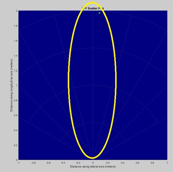

Hi, I have changed the steering angle according to pages 20 and 21 of user`s guide in the beam steering lab to -90 , 90 degrees with steps of 10 degrees but the results are the same as the original code which have -60 to 60 degrees with steps of 20 degrees, in both scenarios I have to put the obstacle almost in front of the radar to get response, if I move the object outside the yellow elipse the radar misses the objective, I expected that changing the steering angle to -90 to 90 I could detect objects in the remaining space outside the yellow elipse but it does not works, am I doing something wrong?
thanks
    The field of view is defined by the antenna. The AWR1843BOOST antenna pattern is described in the EVM UG, Figure 11 and Figure 12
    As you can see in Figure 11 which provides the Azimuth Gain, at +/-90deg the gain is about -18dB compared to 0 deg. There  is not sufficient gain to detect the object at +/-90deg. This is a limitation of the antenna.

  • -18dB is the delta from the Max value in the graph
