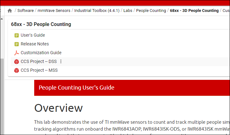

  • Hi Newton,
    Its not evident where you got the above link but you can access the customization guide from the link given in the 3D People Counting Demo landing page in Industrial Toolbox as shown below.
    -Nitin
