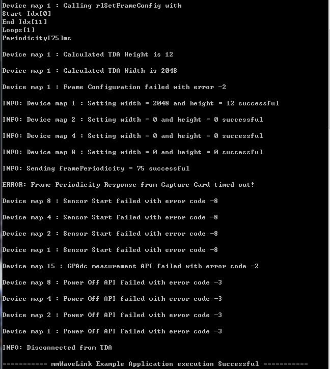

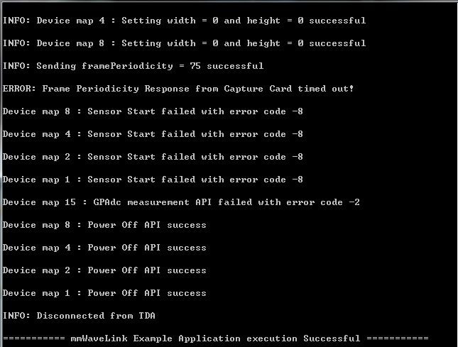

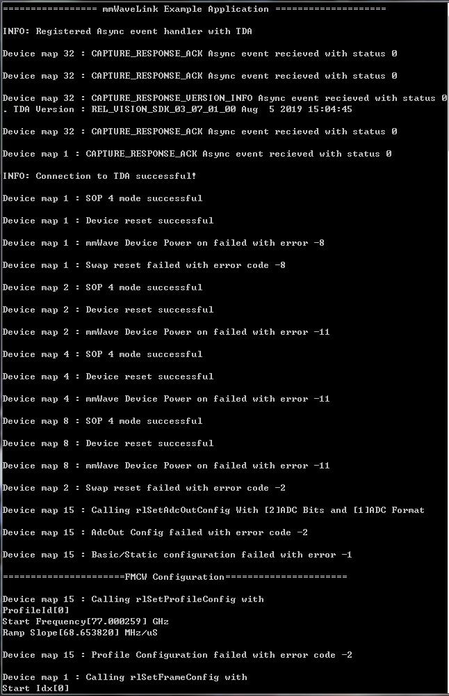

I recently used MMWCAS-RF-EVM and MMWCAS-DSP-EVM to implement automated radar measurements. In order to shorten the time of acquiring data each time, I used the AWR2243_spi_to_flash tool to write the xwr22xx_metaImage.bin file into the flash on the radar chip. Next, I need to complete data acquisition work without using MMWAVE-STUDIO and lua scripts. When using MMWAVE-STUDIO to collect data, everything is displayed correctly, but when I use mmWaveLink_Cascade_Example in the MMWAVE-DFP package to obtain data, there are some problems, which causes the data acquisition to fail. According to the printed information, the problem occurred during the power on process of the millimeter wave device. According to the source code, failure to receive an asynchronous message from the radar device within the specified time will cause this error, as shown in the following figure:

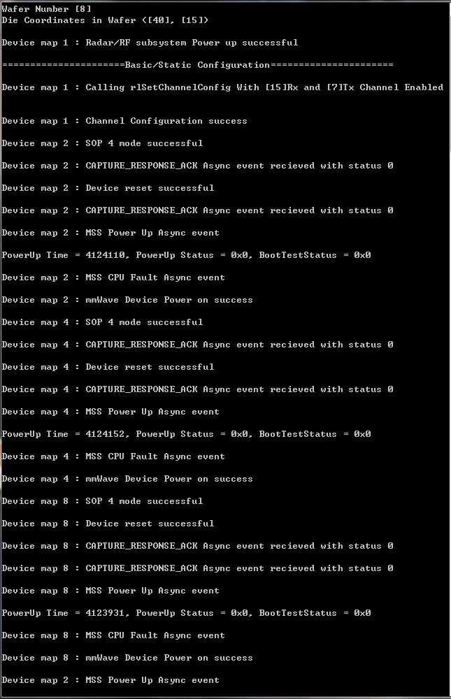

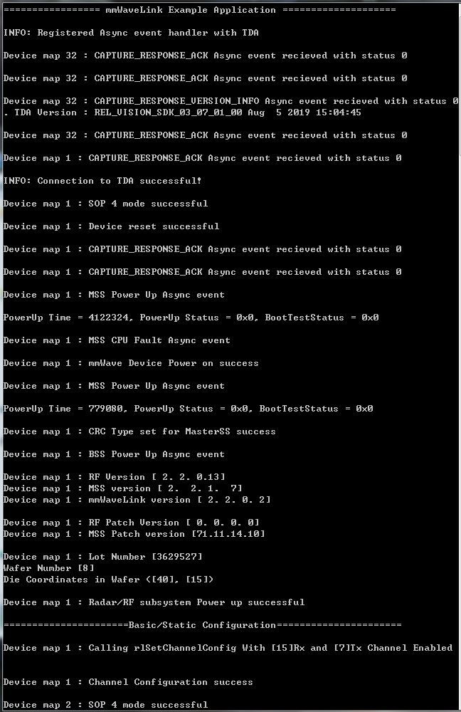

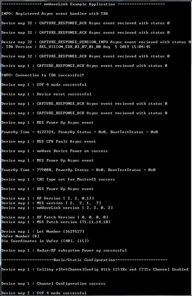

The strange thing is that this kind of problem does not occur every time the device is turned on. The occurrence of this problem is somewhat random. The output under normal conditions is shown in the figure below:
The AWR2243 I currently use is ES1.0 version, mmwave_dfp is version 02_02_00_03, and mmwave_studio is version 03_00_00_07. I want to know what conditions may cause this error and why this has never happened with mmwave_studio. I need to avoid this error as much as possible.
    For the next iteration of the application run, you need to power cycle the board to avoid any kind of error.
    Did you power cycle the board for the above repeated experiment?
    Jitendra
  • Hello there

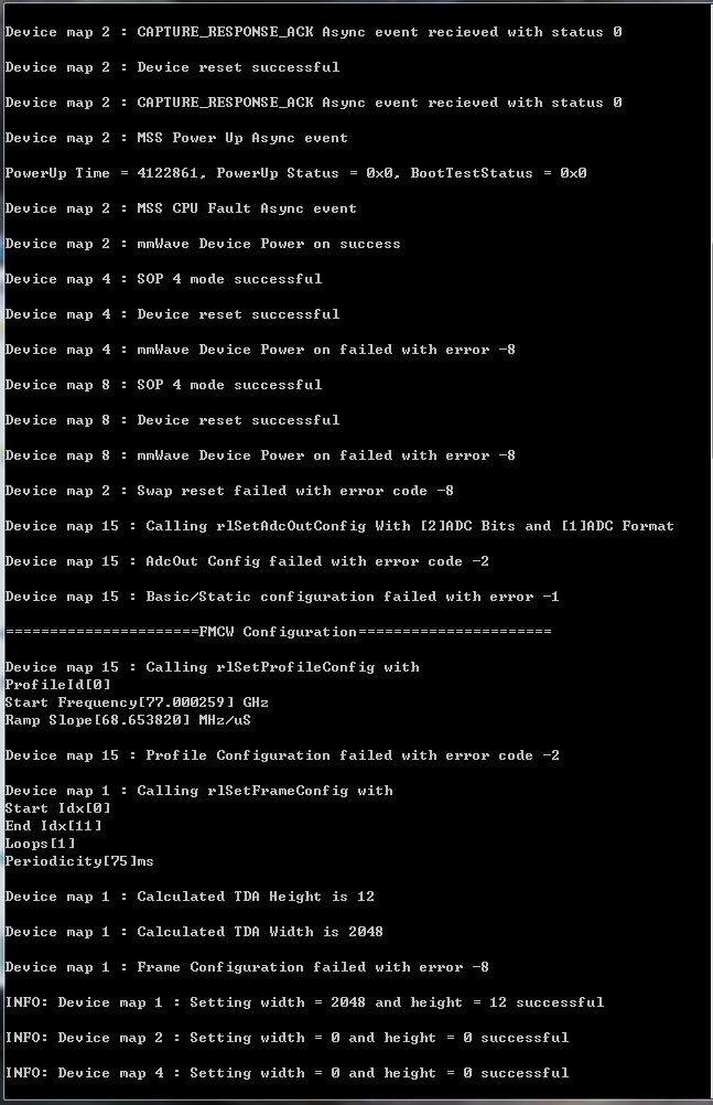

    After many comparative tests, I believe that the occurrence of the device Power on failed error is indeed random, and the power is cut off and restarted between each test. If I use the MMWAVE-STUDIO tool, everything is normal. It can normally receive asynchronous messages from the device and can run stably for a period of time. In addition, during the test, Master Device Power on success but Slave Device Power on failed, as shown in the following figure:
    Are you trying to run using default example exe or compiling from Visual Studio?
    Make sure that you re-build in release mode in the Visual Studio.
    This application is provided as a reference to showcase that from PC you can control the cascade but still recommendation is to use mmwave studio for cascade-related test.
    Jitendra
    My previous experiment has compiled the source code with Visual Studio and released mmwavelink_example.exe. Because I store firmware in the flash on chip, I need to modify some source code accordingly to ensure the stability of program. I will do this work in the next time. Please close this query, thanks.
