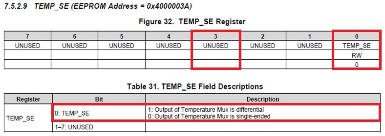

If they set the differential in the GUI, the 3rd Bit of TEMP_SE(TSEM_N) will be 1.
The GUI reads 8(00001000).
In the data sheet (p.57, Table 31), it is stated that 0th bit is set to 1.
Is it a typo in the data sheet ?
