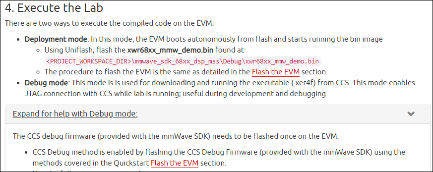

    1. From your description, I assume the customer is using the xwr68xx OOB demo which uses both HWA and DSP for point cloud processing (and not the xwr64xx OOB demo which uses only the HWA for all operations)
    2. Please run the demo in CCS debug mode to get the error shown on CCS console. The CCS debug mode procedure is provided in 68xx ISK - mmWave SDK Demo user guide as shown below (section - 4). The error description from CCS console is required to understand the problem (e.g. is it memory or MIPS related).
