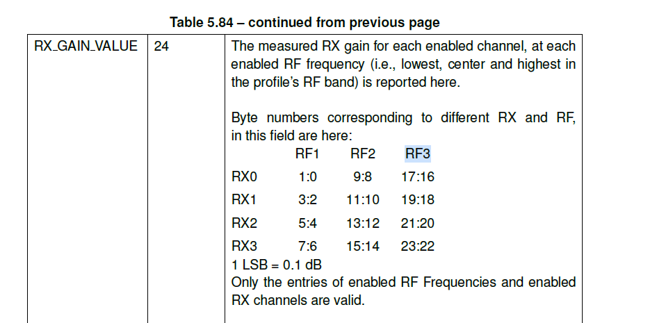

In the mmWave-Radar-Interface-Control.pdf , we can get sub block 0x1018 – AWR MONITOR RX GAIN PHASE REPORT AE SB callback report  in three RF bands(RF1,RF2,RF3) and four rx channels , I want to known the exact meanning of RFx  and the bandwidth of RFx

    Here RFx means the lowest, middle and the highest frequency in your configured chirp profile.
    Say for example you configured a chirp with 1GHz of bandwidth and the start frequency 77GHz. In that case,
    RF1 = 77
    RF2 = 77.5GHz
    RF3 = 78GHz.
    Hope the information is clear.
