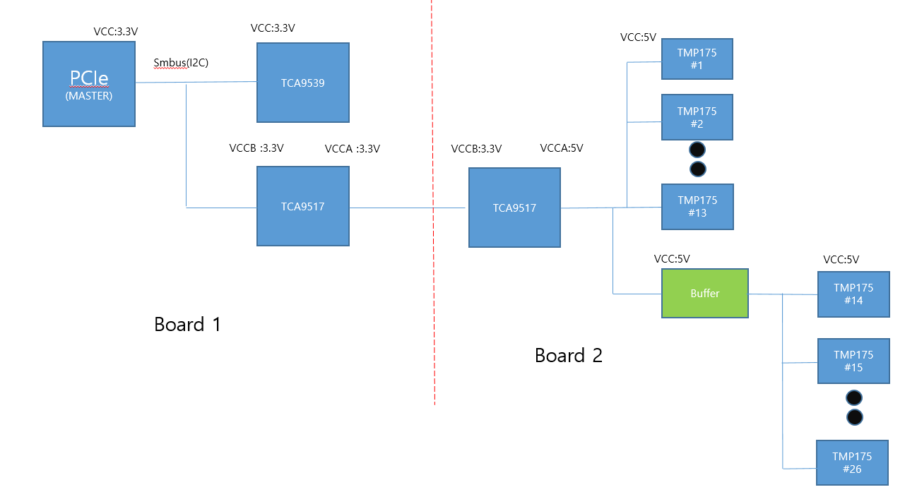

hello
I try to measure temperature using TI device (TMP175).
There is only one bus which is communicating with I2C, but I need 26EA device(TMP175) in parallel.
I had two concern, First I need device which have many slave address . Second I need to reduce bus capacitance. (limit 400pf in I2C )
That's why I chose TMP175 and I decide to add buffer. But I don't know what i have to choose yet.
I attached my block diagram. Is there any problem ?  Could you plz recommend any solution and you can choose buffer ( TI's device)
Board 1 is made already . I try to design board 2 now.  3.3V power is short in board 2 . So I have to use TCA9517 to shift to 5V.
Thank you.
    The TMP175 does have up to 27 different addresses so this should meet your 26 different address requirement.
    Do you have concerns with the I2C bus after the 2nd TCA9517 capacitance being too high?  Each TMP175 input capacitance should be ~3pF which would be under the 400pF max.  if you are concerned with the capacitance still though is there a reason you wouldn't want to use another TCA9517 as a buffer?
    The TMP1075 has up to 32 addresses and has better accuracy and current consumption which may help in your application seeing that you are using many of these devices.

  • Hi, David
    Thank you for your recommend.
    Let me reply below questions.
    --> I think so .
    -->  Yes I am worry about that as you mention.
           I attached circuit board 2  but a little bit different compare to previous blockdiagram.  Could you please check that out?
          TCA9517#1 : For voltage level shift because of different vcc voltage between slave and  master.
          TCA9546 ( IC Switch ) : Separation CH . For reducing bus capacitance and long bus which makes spike noise in data line.
          TCA9517#2,3,4,5(As buffer)  : For reducing bus capacitance
          I will change resistor value after calculation.
          If you have another solution  Please let me know.
    --> I think , address number is enough now.  But let me consider this part.

    I have a couple concerns with your schematic.
    1. There is no net on the TCA9546 I2C Switch to control what channels to enable and communicate to the different devices.
    2. There are many redundant pull-up resistors on the I2C bus which will create a very strong pull up since they all will be in parallel.
    David
