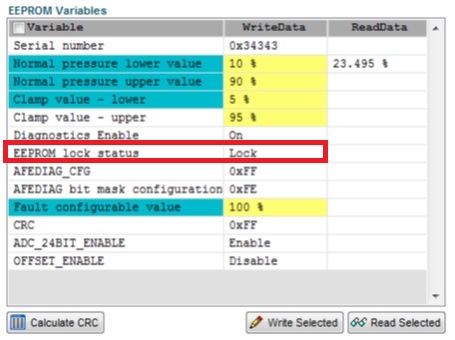

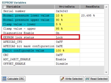

  • Hi Tom-san
    I checked with my customer.
    They used the GUI to write the EEPROM.
    After writing with "EEPROM_LOCK" locked as shown below, they changed the value of another part (e.g. the value of PGAIN) and tried to write it.
    As a result, the changed part was changed.
    If we use the GUI to write, isn't it written after the Lock is released ?
    Please confirm the writing procedure of the GUI.
    Customers are still only able to write in the GUI and cannot get confirmation of writing in other ways.
    Koji Hayashi
  • Hi Koji,
    Scott will confirm the GUI lock operation.
  • Hi Koji-san,
    The EEPROM lock is enabled when you set the lock bit, however the GUI itself supplies an unlock code when the PGA305 is put into digital interface mode. This allows the EEPROM to be read or written through the GUI.
    You should be able to test that the EEPROM lock is successful by manually resetting the PGA305 using the low-level configuration page of the GUI and setting the COMPENSATION_CONTROL register to 0x03. This will allow digital interface communication, but will not send the EEPROM unlock code, and you can confirm that it is not possible to read or write to the EEPROM.
