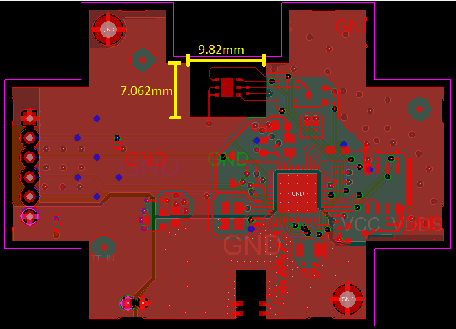

Hi Team,
I am using HDC2080 part on board but we are having accuracy issue with mechanical. I need guidance on this to have review PCB layout to ensure there is no issue from layout side.
Application note SNAA297A has been followed for PCB and mechanical.
I am just thinking if there will be any issue in PCB side then might be due to self heat of Ic, we won't be able to meet accuracy.
Please check attach PCB image with marked area of HDC2080 Ic. I have mentioned no copper area for all four layers.
I have observation that if I am closing all opening vent and then using exposed metal from enclosure and exposed metal is touching Ic by using Thermal pad then in that case accuracy is coming better. But in this case, we will have humidity issue because air flow will be blocked fully.
Can you please guide or help us if we have any other guidelines to achieve better accuracy or we can improve in PCB layout.
Let me know in case if you need more input from my side to help in this.

  • Hi Josh,
    My bad if i did not convey all msg. But i think i already shared all data. Issue is in accuracy with mechanical and those accuracy is more in negative temperature side like below 0C.
    And i shared PCB layout image for your reference to see if that much no copper area near HDC2080 is sufficient?
    Let me know what all inputs do you need other than above explained things.

  • Dear Josh,
    we don't have fix offset actually and that is one of the reason not to get it fixed by firmware by simply adding same offset in firmware.
    Below is the observation:
    1. On Negative temperature specially when i measured then offset is too much high.
    For example, I have done testing of two devices with everything same configuration, Mechanical , firmware and tested with NABL certified chamber and master probe.
    One sensor has offset of 1.68C while other has 0.58C, both devices kept even for long time (Approx two hours) to get it settled.
    2. Attached excel sheet of two different temperature one with chamber temperature of -30C and other at 0C.
    3. In first sheet we have temperature sensor with three sides vent (checked with two vents also as per guidelines) but no luck.
    4. Then done one more experiment and in that i have kept one thermal pad on HDC2080 Ics and then one metal part which is exposed outside with mechanical. In that accuracy is coming better than other device configuration but humidity reading is not possible because here Ic is covered by metal and thermal pad.

  • Sumit -
    unfortunately - it is still not clear what your issue is. it seems as though you are describing a temp difference, but i cannot tell where your reference probe is vs the sensor. if you are looking for correlation, you need to get reference sensor as close as possible to the device under test. So your issue may be in the way you are measuring it - perhaps some closer and clearer images of what you are doing here might help alot.
    Also, at cold temperatures, the temp sensor on the HDC2xx devices as shown on figure 3 on page 6 of the datasheet will deviate typically as shown. You should not attempt measuring %RH at the cold temps, as this really makes little sense in most applications.
    Lastly - on HDC2080, you need to subtract 40.62 at the end of the equation when calculating temp. (vs. just subtracting 40)

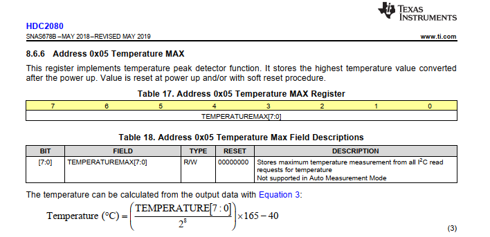

    Lastly, why are you suggesting to subtract 40.62 instead of 40?
    as per datasheet it should be 40 only. Please suggest.
  • Sumit -
    Section 2.3 here has various thermal conduction use case layouts for you to reference.
    https://www.ti.com/lit/an/snaa297a/snaa297a.pdf
    The update to the calculation is coming soon to the HDC2080 datasheet, just sharing that with you early.
    The temperature accuracy for the HDC2080 is defined between 5C and 60C, and any error that might be seen will be between 0.2 and 0.4C.
  • Hi Josh
    I am referring same datasheet for temperature calculation and it is suggested to subtract 40 instead of 40.62, Please refer attached image for your reference.
    From where you got the subtraction digit of 40.62?
  • Sumit -
    Correct. where the -40 is, will become -40.62.

  • Sumit -
    it is simple. instead of subtracting 40, just subtract 40.62.
    For example: HDC2080_temp_celcius = ((float)(HDC2080_temp_DEC) / 65536) * 165 - 40.62;

  • Sumit -
    A smaller negative # is "bigger" than larger one. the math still works below 0. All we are doing here is taking away 0.62C more than before.
  • Hi josh
    So are you saying that the modified formula(i.e. the one which subtracts 40.62) is applicable for all temperatures(positive as well as negative temperatures)?
  • Sumit -
    Yes, it appear that way - for one example, if you had output of 0x1FFF (8191d) for the temperature (registers 0x01 and 0x00), then you would have (8191/65536) * 165 - 40...which results in 0.1249847 * 165 - 40, which results in 20.62248 - 40, which equals -19.37752C, if you then replace with 20.62248 - 40.62, this would equal 19.95752, which is same impact desired as what is seen on positive side of 0C. Make sense now?
