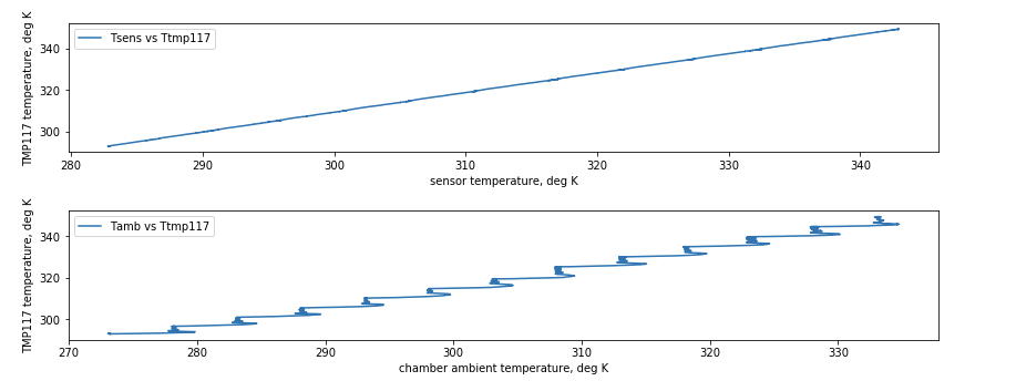

Here is the plot of sensor vs tmp117 temperature and chamber's temperature vs tmp117.

Now, if it was just the difference between sensor being calibrated and TMP117, I would just assume that other sensor has non-linear behaviour and that's it.
If the housing would indeed increase it's heat dissipation properties (i.e. assuming a constant heat input from electronics)- the other sensor would also register it- but it's registering exactly the same temperature difference than
climatic chamber is.

  • The absolute temperature of housing would definitely differ from other locations: but what I am looking at is the steady-state temperature rise (i.e. place the product in chamber at 0 deg C, let it stabilize for 90 minutes, set chamber to 60 deg C, let it stabilize for 90 minutes).
    I would expect the temperature rise of housing match the temperature rise of ambient/operating temperature, given that the products heat dissipation does not change and there is no active cooling happening. What I am seeing is that temperature measured by TMP117 rises by 56 deg C, when the ambient temp. rises by 60 deg C.
    I have now instrumented the same calibration process with another, free standing TMP117 just to make sure that the climatic chamber temperature does indeed rise by 60C, but I'm fairly sure it will (chamber uses PT100 DIN class A RTD and still has a valid calibration certificate).
