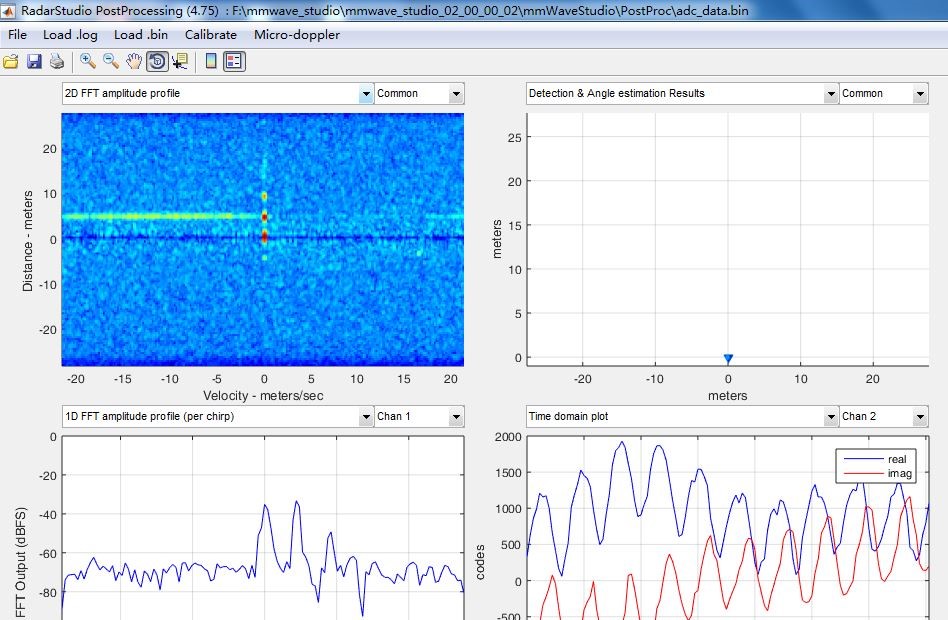

Now we are trying to measure the Doppler of Unmanned Aerial Vehicle. We have the UAV hovering over the radar, and the following are the Chirp parameters:
Frequency Slope:75 MHz/us
idle time:4 us
ADC samples: 64
Sample Rate: 12000 Ksps
Adc Start Time: 5 us
Ramp End Time: 12.12 us.
The following picture shows the Doppler feature of UAV.
Fig. 1
However, only the negative Doppler component can be detected.
The following picture shows the Doppler-Range Map in mmWave Studio, we can also find that only the negative Doppler can be detected (We use another Chirp profile to obtain the following picture. ).
Fig. 2
So, could you tell us why only the negative Doppler component can be detected? This problem has confused us for a long time.
