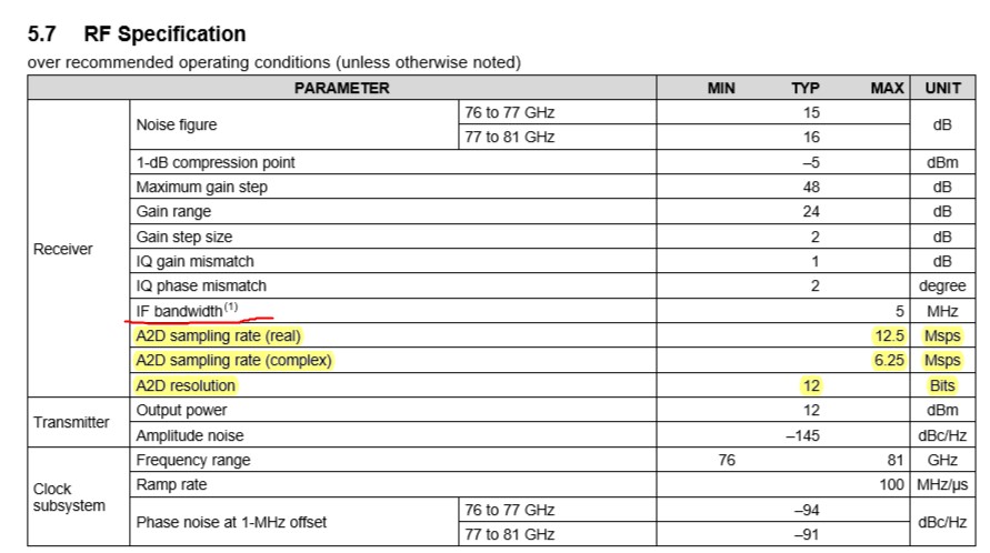

Hi:
I found IF Bandwidth in AWR1642 is 5MHz, while complex sampling rate is 6.25MHz. I doubt that the last part of FFT frequence (5MHz~6.25MHz) is useless because IF Bandwith is 5MHz. Or how to understand the IF bandwidth parameter? Thanks!

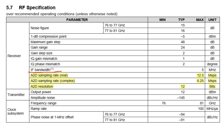

Hi:
