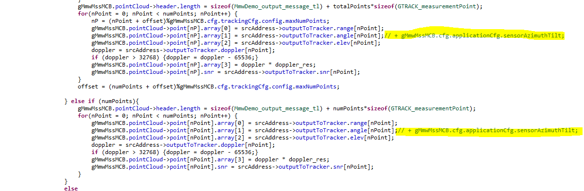

If I want to tilt the radar to 22.5 degrees of azimuth as fig.1, can I just remark the code as fig.1 ?
Fig.1 : sensor azimuth
Fig.2 : the code is in toolbox 3.4.1 overhead people counting
1. Azimuth tilt is not supported in the overhead people counting demo.
2. We recommend using the latest overhead 3D people counting demo in Toolbox 4.4.1 or above. The overhead demo in toolbox 3.x is deprecated and no longer supported.
Link to toolbox 4.5.0: http://dev.ti.com/tirex/explore/node?node=AF4jhFuBH13mLPnsCXgawg__VLyFKFf__LATEST&r=VLyFKFf__4.4.1
-Nitin
