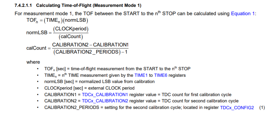

I'm running TDC with SPI communication (without LaunchPad)
As I refer 7.6.1. register map on P.24, I come up with few questions.
1. For measurement method 1, can I skip CLOCK?
- TIME
- CAL1
- CAL2
Only above 3 seems to be necessary for measurement method 1.
2. What is the proper moment to read Retrieving Data & Processing?
(After sending START1 and STOP1 signal to TDC, when can I start to read TIME, CAL1 and CAL2)
