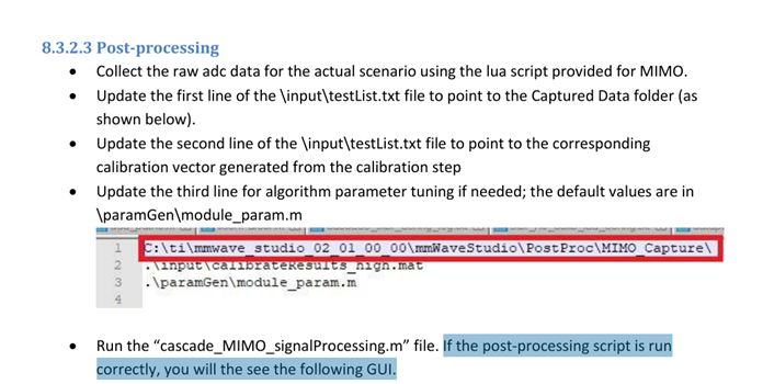

According to section 8.3 in the instruction manual, the customer set the matlab path, ran addpaths, and modified the path of testList.txt. But he encountered a problem when running cascade_MIMO_signalProcessing.m.
C:\ti\mmwave_studio_03_00_00_14\mmWaveStudio\PostProc\12bit\
C:\ti\mmwave_studio_03_00_00_14\mmWaveStudio\PostProc\12bit\input\calibrateResults_high.mat
C:\ti\mmwave_studio_03_00_00_14\mmWaveStudio\PostProc\12bit\paramGen\module_param.m
This is the testList.txt file he set.
Customer writes according to the format in the manual. But there is a problem when reading the second and third lines, so he replaces. with the full path.
In addition, there is no input file and paramgen file in the file where the data is collected. He put these two files in the matlab example by himself.

    Yes, the "input" and the "ParamGen" folder is not a part of the captured file and Hence the paths changed by the customer in the "TestList.txt" file are wrong. Below is the default path for the above two folders :
    C:\ti\mmwave_studio_03_00_00_14\mmWaveStudio\MatlabExamples\4chip_cascade_MIMO_example\main\cascade.
    Can you let us know the error your customer is getting with the default testList.txt? (Assuming the default paths and only the first line pointing to the captured data folder is updated)
