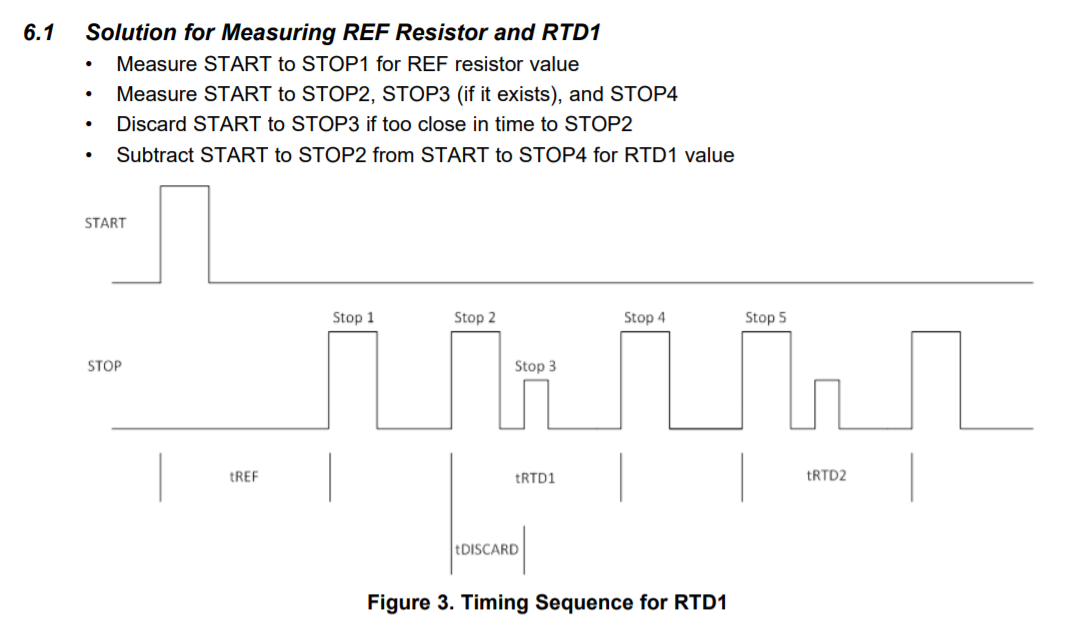

I have a problem with measurement temperature base on TDC1000 and TDC7200.
I can measure TOF for wind sonic look good already, now i try to do compensation for it base on temperature RTD1/RDT2 base the Tim1 to Tim6 data look do not stable:
My system: external clck 10Mhz
Now I connected Ref, RDT1, RTD2 = 1k to test fisrt. I expect Tref, Trtd1, Tref2 must near same. but it do not, every i measure, it got very different result.

wait until finish and read Timer 1 to timer 6 and result it not stable, like that:
          TIMER1...............................................................TIMER 6
1478.0,    1572.0,   1534.0,   1711.0,  1584.0,       817.0

  • i read all and it not help. every i read 6 timer, it got different value, i thought it must TIME1<TIMER2<TIMER3.....<TIMER6?
    or please correct me how to take correct Tref, Trtd1, Trdt2 with that value?
    Thanks you
    The RTD nominal value may be calibrated around 0 degrees C, causing you to see a difference, since the REF value should ideally remain constant across temperature.
    Also, the TIMEn values for TDC7200 measurement modes 1 and 2 are described on pages 15-18 of the data sheet. For mode 1 the values for TIME1..TIME6 increase, but for mode two that is not always the case. This section of the datasheet may help you interpret your results.
    Have you read sections 4 - 6 "Temperature Measurement with Multiple RTDs" in this app note: SNA230 ? If you have an oscilloscope and can look at START and STOP this may help you debug.
