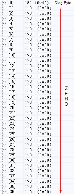

1) The response begins with a DIAG-Byte (0x40) followed by a Number of Null-Bytes. The Count of Null-Bytes varies in response frames from 106 to 124. Should it be a constant count of Null Bytes? Whats the right number of Null-Bytes. In a recent post there was mentioned that null-bytes are sent for about ~120us.

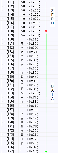

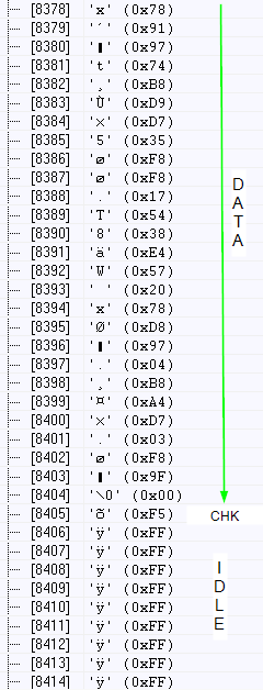

    I can see, that the byte count varies from frame to frame. This includes the number of Null-Bytes at the beginning of the frame as well as the following number of data bytes. In all cases the Check-Byte matches, so i assume the frames are valid.
    In the following example frame (12bit data, Burst and listen)  there are 118 Null-Bytes and a total frame size of 8406 Bytes.
    This is much more i would expect. As mentioned before, rec_len=1, so i expect 2*4096 = 8192 Bytes.

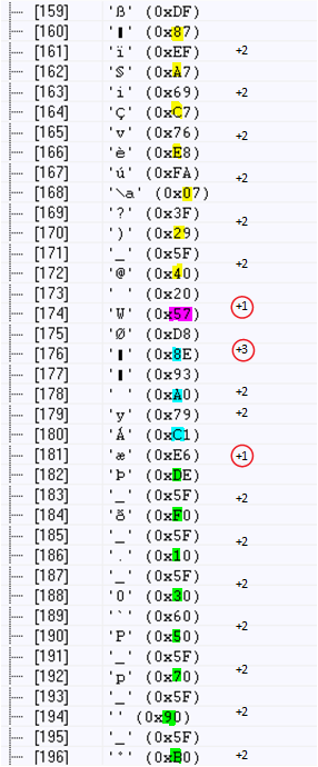

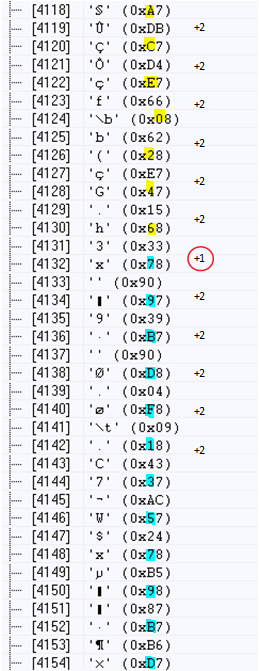

    I made an interesting observation by checking the sample counter padded to the 12bit sample data. Normally it incements by 2 from sample to sample, but occasionally it increments by 1
    I assume that these readouts are caused by unmatching clock rates.
    In this example frame there are 45 of these samples.
    Now I tested other prototype boards with similar results. One board with a particular good clock matching showed sample counter increments from 1 to 3.
    I compared three different boards, an found that this behaviour was dependent on the board. So each board showed a little different clock matching. One board showed about 45/46 increments by 1. Another board showed about  58/59 increments by 1, and one board with really good clock matching showed mostly no irregular increments.  But this board showed another effect, that i saw occasionally. There where quite long sequences of 1/3 increments.  Maybe the clocks where a little out of phase.
    When I added up all increments of different frames I realized that there were really little difference   (max. 3) and this also across different boards. So I think it does not really matter that the samplecounter increments are varying.  Maybe if the readout is too slow, it is possible to loose samples, because there is no buffering.

    The Null-Byte Sequence at the beginning of response frames showed no tendency and varies about 104 to 122 bytes.
    One thing seams to be clear: The Null-Bytes come on top when calculating total frame size.

    I was able to run some tests from my side on this. From the tests, the count of null bytes can vary between different runs. To help synchronize the microcontroller to the PGA460, you can do processing on the microcontroller to identify when null bytes have stopped being sent and then looking for the pattern of incrementing sample counters within the first few bytes.
    If the SPI clock is 8 MHz, you would see the sample counter increment by 2. You can see the sample counter increment by more than 2 if the SPI clock is less than 8 MHz.
    Also, adding zeros to the checksum calculation doesn’t affect the calculation, so the number of null bytes in the payload should also not affect the checksum calculation.
