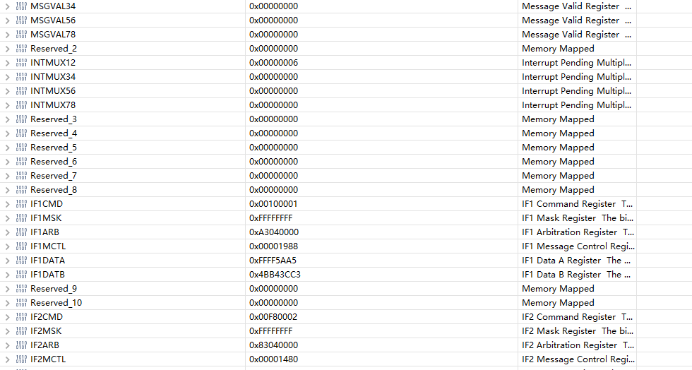

Customer connected AWR1642BOOST-ODS CAN TX and RX to TJA1050 transmitter via J5 and J6 connector. And then flash the test code in SDK CAN driver and run the code. But there is no wave from AWR1642 C13 and E13 pins while the data has been written to the CAN registers
He has changed the hardware mentioned in  2.3.3 CAN Interface Connector.
