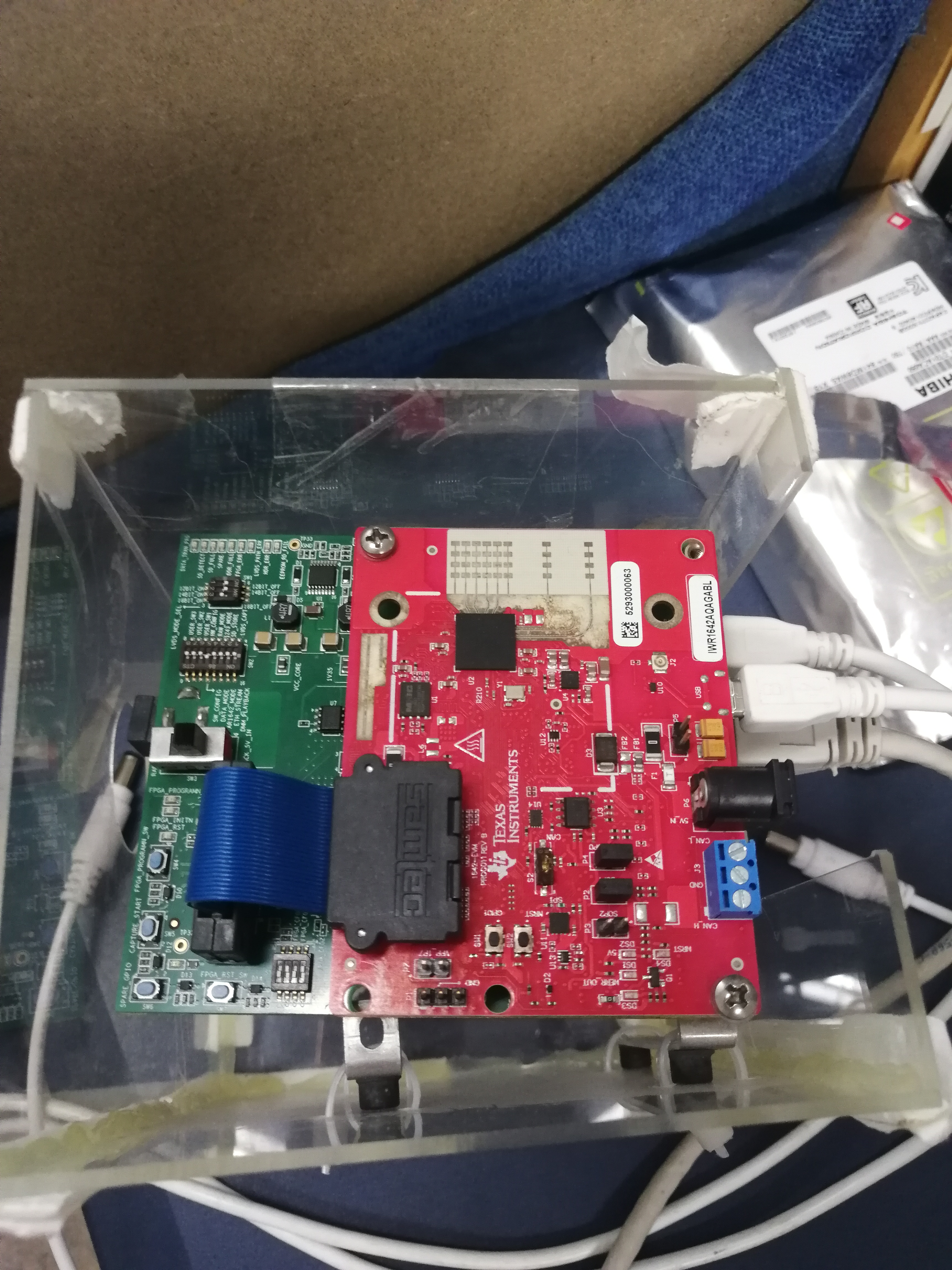

    When I clicked the DCA1000 ARM and Trigger Frame after all the steps following the mmWave Studio User's Guide,some problems appeared : " LVDS buffer full ", " Record Process : Timeout Error! System disconnected "

  • HI,
    Can you look through the DCA1000 training video at https://training.ti.com/dca1000-training-video
  • In fact,I have seen it many times.
    I also tried to reduce  the periodicity in the radar studio sensorconfig settings,but it didn't work,after Trigger Frame ,the FPGA_ERR_LED would turn to red, and the LVDS buffer full still appeared in the output
  • Hi, there:
    Can you install radar studio under c:\ti  directory instead of D:\ti directory?
    Zigang
  • I have tried this before,but it didn't work
  • HI, there:
    Can you send me a picture of your setup before you trigger the capture?  I would like to check your switch settings on DCA1000.  It should look like this
    Zigang
  • hi,
    Can i check if you manage to resolve the LVDS buffer full issue?
    if yes, what is the root caused?
    Felix
  • I have another customer that see LVDS buffer full and see the error goes away when they remove the SD card.  Have not get updated from this user.
    Zigang
  • I'm the user6470753,I just can't log in my account,and my campus mail can't receive the email (sad).so I registered another account.
    when I get the board from my teacher,there's no SD card,and it was used by schoolmates senior to me.So, I didn't change the setting of hardware.
  • I'm sorry I didn‘t solve this problem
  • Please change the DCA1000 switch setting as the picture I sent before.
    Please look through the capture issues in the DCA1000 debug handbook.
    https://e2e.ti.com/support/sensors/f/1023/t/872161
    Zigang
  • But I shouldn't set it like that,If I  set the SW2.2 at pin2 following the picture,the data will be saved into the SD card,but I don't have SD card,so,instead,I
    should set it at pin15,then the data can be streamed over the network to the post PC.
  • HI, there:
    We program sw2.5 to software control, so the other switch sw2 settings are in general ignored.
    Check section 2.6 at: https://www.ti.com/lit/ug/spruij4a/spruij4a.pdf?ts=1605558347677&ref_url=https%253A%252F%252Fwww.google.com%252F
    Zigang
  • hi Zi Gang,
    I am the DFAE helping to troubleshoot on this issue. So far, i have checked on their setting and find all HW setting and SW setting are correctly set.
    1. PC firewall is turn OFF
    2. In C:\ti\mmwave_studio_02_01_01_00\mmWaveStudio\Scripts\DataCaptureDemo_xWR.lua, we have change the following:
    1. Line 236: change package delay to 500us, (ar1.CaptureCardConfig_PacketDelay(500) == 0)

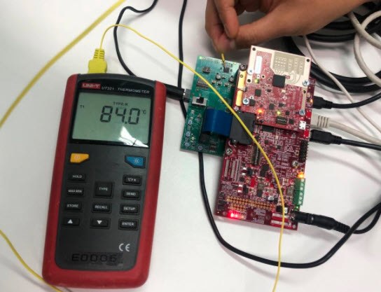

    is this possible for you to form a same setup and test on your side or we can ship this setup to you for you to test on your side. show us how this thing work?

  • The LED6 light turns red,so I tried to change the periodicity to 200ms, but it did't work
  • Which one is LED6. Please take a picture of your complete setup with the error LED red. And sent over the complete log as well.
    Did you also observe the high temperature on DCA1000 board as mentioned by Felix?

    I observed the high temperature on DCA1000, but I didn't test how hot it was.

  • “LVDS buffer full” appeared in the CLI after clicking trigger frames,the FPGA_ERR light still turned red, and the DCA1000 was hot, so I didn't wait for record stop successful in the CLI and cut off the power.
  • HI,
    IT is very likely that your DCA1000 board is broken.  Can you try a different DCA1000 board?
    Zigang
