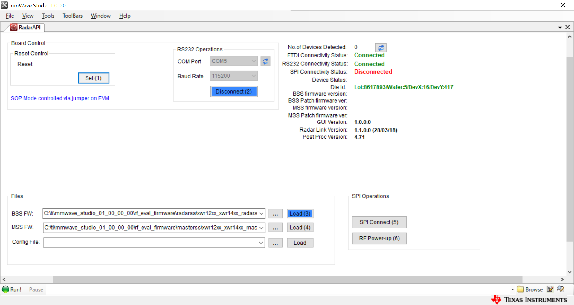

以下のデモを実行したいです。
No.of Device Detected: 0
I don't know how to solve this.
Where is the cause?
The software you are using is:
SDK.1.01.00.02
Mmwave Studio1.0.0.0

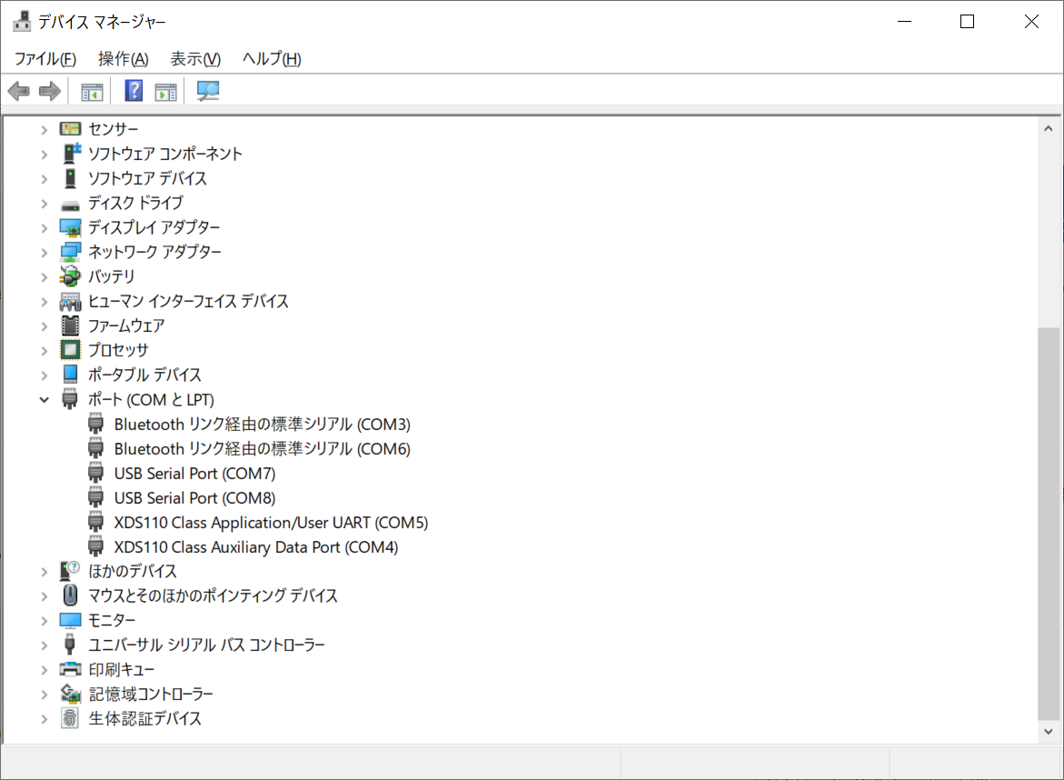

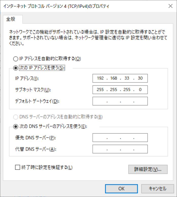

By the way, the Ethernet cable is as follows.
The COM port looks like this.

HI, there:
It looks like the USB port is detected correctly, you should have total 6 detected from the setup. Please go through the DCA1000 training video step by step:
