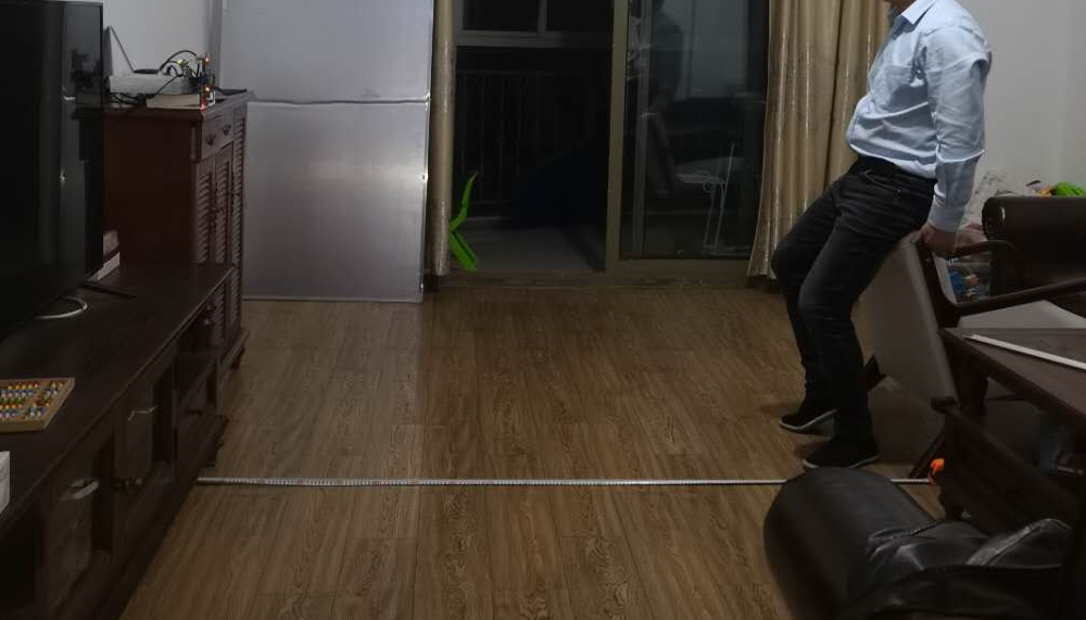

There is a person in front of the IWR6843ISK about 2.00m
I get ADC binary by "DCA1000EVM_CLI_Control.exe"

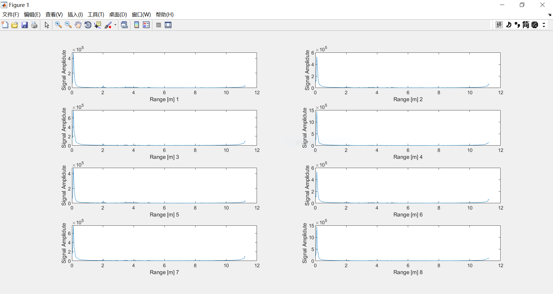

The result show the large DC component ,profile_2d.lvds.cfg
below is the first frame range information.

    And the DC Component singal strength for 4Rx is different:
    certain is 4.5*10^5,
    certain is 15*10^5;
  • user6378202,
        Due to Tx to Rx coupling at the antenna and board traces, It is possible to get high DC component due to this leakage.
    You could change the HPF filtering corner frequency to reduce the DC component levels. Also you may try to increase the ADC_start time as well.
