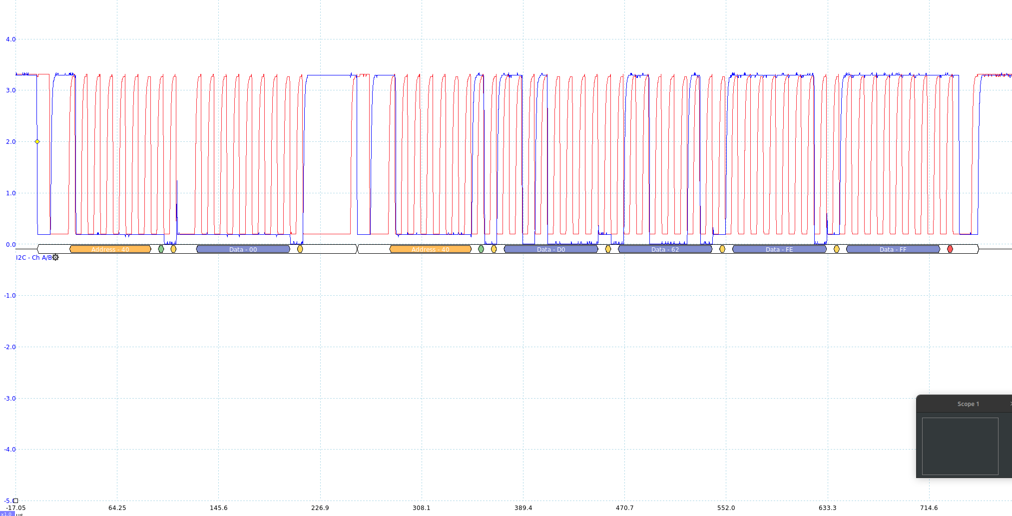

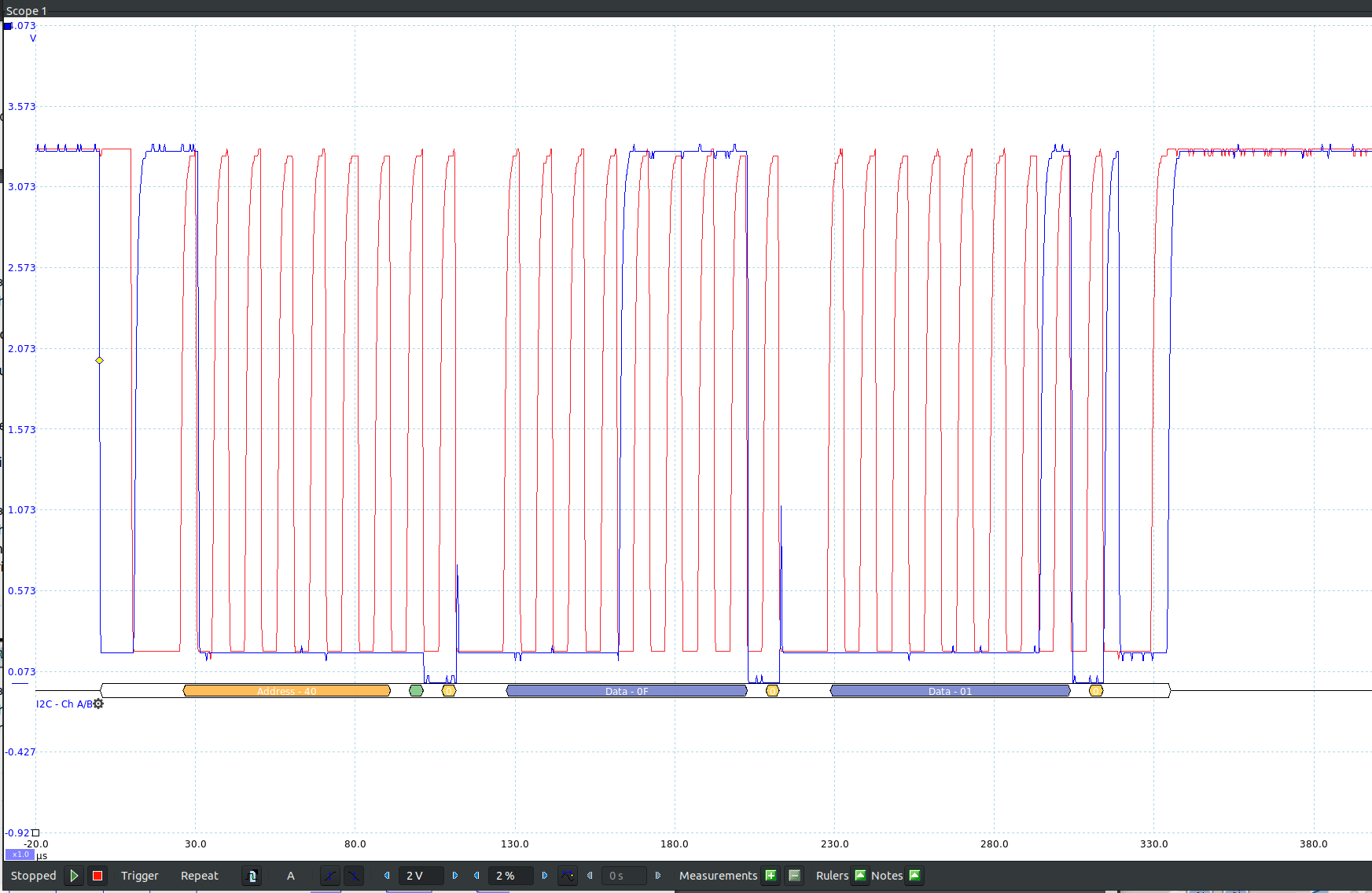

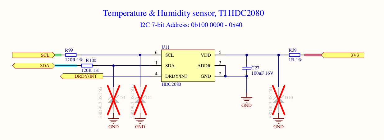

  • Hi and thanks,
    I added two captures. Sending the Start measurement command and reading the temp/hum registers. I also added the schema of the sensor. I2C captures are taken from the sensor side of R99 and R100. I also measured that VDD remains stable at 3.3V when measurements are made. There are lots of other I2C slaves connected to the same bus.

    Your I2C waveforms look like the part is properly ACKing your commands, but it seems like you may have a lot of bus capacitance based on the shape of the rising edges, possibly due to the multiple devices you have on the bus. Have you ensured that none of these devices are inadvertently configured for the same address of the HDC2080?
    Also, are your I2C Controller and the HDC2080 sharing a ground plane? The HDC definitely appears to have a lower VOL than your controller based on these waveforms.

    I've seen voltage differences like this before, but your traces don't seem like they are really long enough to cause this much difference in the ground level. It appears that this kind of voltage offset is common with serial resistances (see https://www.i2c-bus.org/i2c-primer/serial-resistances-and-debugging/). If you can short these series resistors on one of the failing boards it would be a good way to prove or disprove this. Most of our sensors are rarely used with these series resistances. I would also try shorting R39 at the same time just to remove that as a variable.
    You do not have D3, 4 and 10 populated correct?
