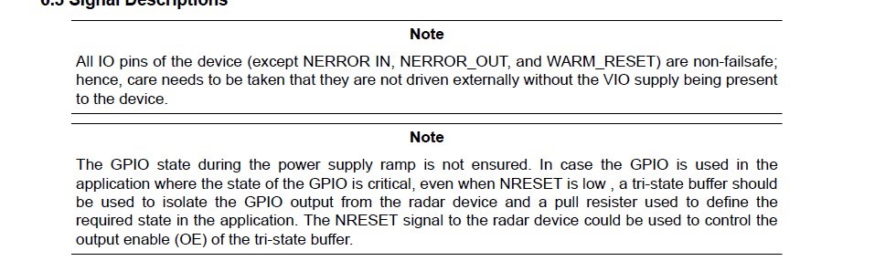

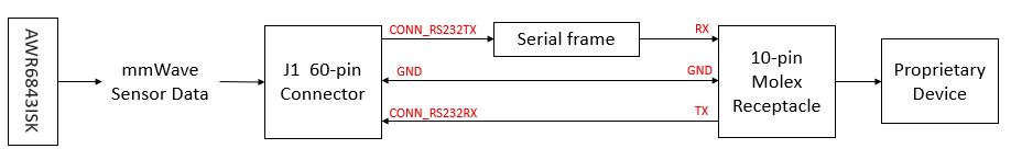

I need to stablish serial connection between the sensor and a device that has a 10-pin Molex Header. For this purpose, I am using the configuration of the UART muxed to the 60-pin connector and supplying power to the board by the mini-USB port (using the serial in the USB port is not an option).
I am planning on making my own cable as the only data lines I need are Tx, Rx and GND. I thought of using a SAMTEC cable (or directly getting the QTH-030-01-L-D-A connector) and modifying it for my purposes.
Would this work and are there any risks I need to be aware of?
