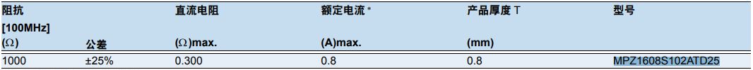

    Customer is doing a new design with PGA411-Q1 and considering cost and size requirement, they do not want to use 2 power rails for VCC and VIO, and the have several questions regarding this:
    1. Why PGA411-Q1 require VCC ready before VIO? I guess it's because the core should be powered before I/O?
    2. It says in the datasheet that "VIO should never be supplied before VCC is stable", does this mean VIO should stay 0V before VCC reach 5V? But datasheet also says we can use current limit resistor so I assume the requirement is not so strict? Is it ok for customer to make VIO rise along with(but slower than) VCC?
    3. For the current limit resistor, do we have any suggest value/package? Is there any need to add a capacitor?
    4. Can we use bead(spec as below)+capacitor instead of current limit resistor?
    Thanks again.
