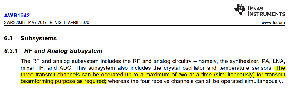

While reading the datasheet for AWR1642 (document ref: SWRS203B-MAY2017-REVISED APRIL 2020), in section 6.3 I came across the highlighted text as below, which confused me.
Could you please confirm this is a typo? If it is not a typo, could you please elaborate further on how beamforming can be achieved on AWR1642? (I was under the impression that beamforming was not supported on AWR1642)

    AWR1642 Beamforming means that both TX are enabled at the same time. The result is that more energy is transmitted, which results in a longer range.
    Note that this does not mean that the TX beams are steered in a direction. This feature is only available on AWR1843.
    The AWR1642 SRR demo provides and example of beamforming using AWR1642.
    This demo is available in the Automotive Toolbox provided in the TI Resource Explorer
    Please also see the associated TI design (read especially the TI Design Guide)

    As I understand, I can enable TX1 and TX2 at the same time on AWR1642 if I want to increase the detection range. If I want the beam steering capability, I need to work with AWR1843, which is equipped with analog phase shifters to control each transmit stream individually.
