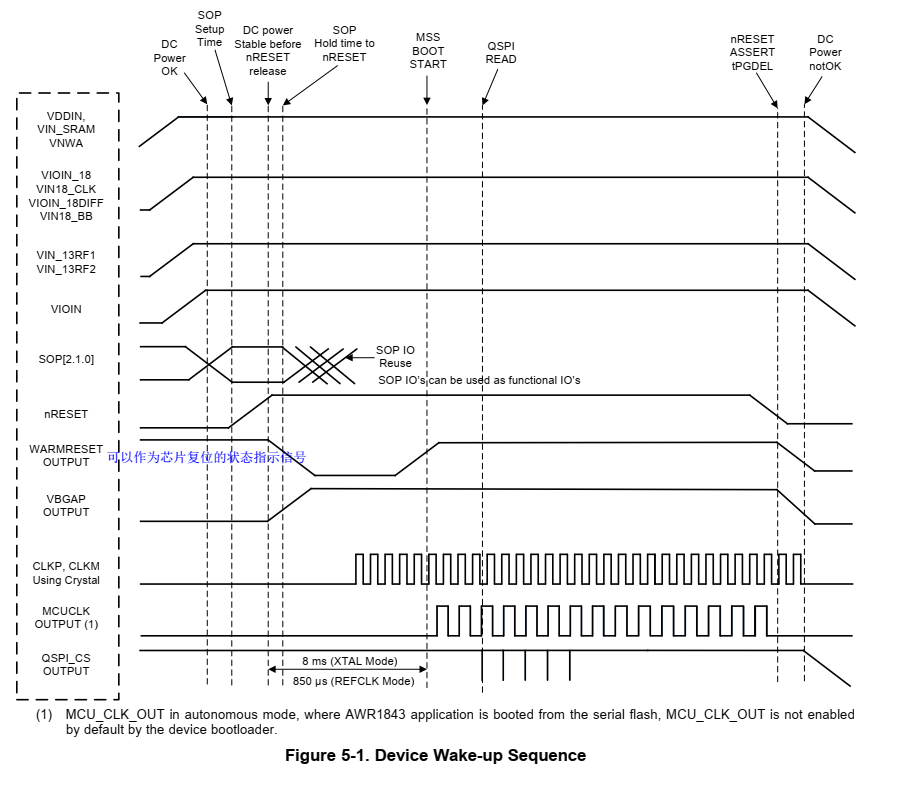

Hello champion,
Do we have a measured executing time of different steps in AWR1843 boot up procedure in below figure?

Hello Adam,
From nReset the Vbap comes up within 1msec. The warmreset is complete 8 msec from nReset and at this point bootloader execution starts followed by initialization. This takes ~30msec Post that the application load from serial flash starts.
