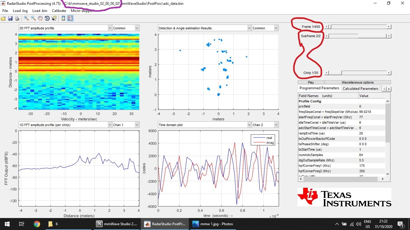

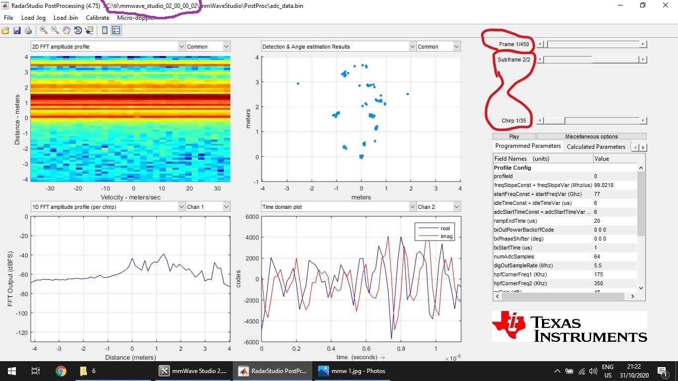

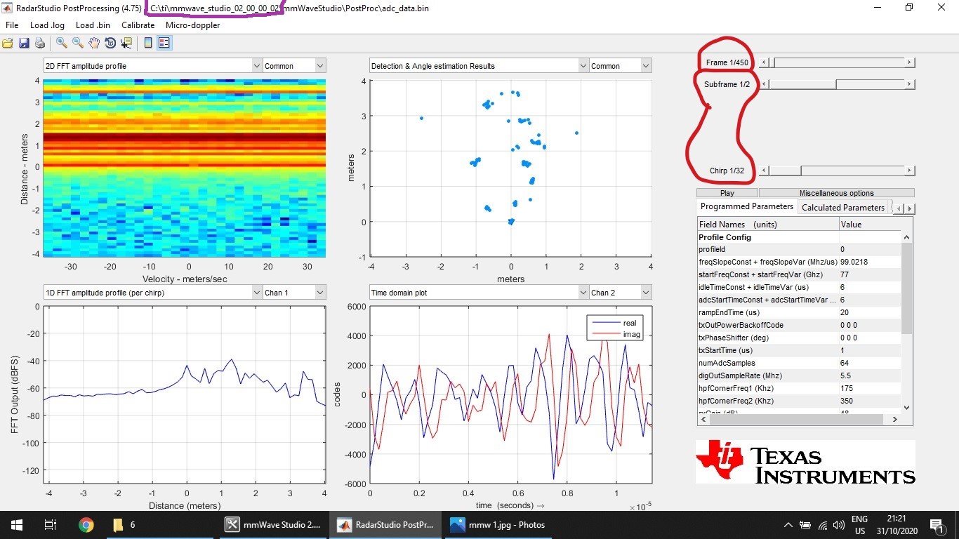

I am using AWR1642BOOST (ES2.0) + DCA1000 EVM, mmwave Studio 2.0.0.2 for acquiring adcData. I am using 16-bit ADC data in 2x Complex format for one Tx and two Rx. I have  tried to collect the data for 450 frames, with 4.4ms interframe time. I have used two sub-frames in one frame; one frame had 32 chirps and the 2nd subframe had 35 chirps. Both types of chirps had 26us chirp time for 64 adc samples/chirp.
I tried to get the output on the GUI by using the PostProc utility of mmwave Studio. It SEEMS that it worked fine when I got the following figures:
FIGURE 1
FIGURE 2
We can see above 450 frames and sub-frame one having 32 chirps and sub-frame 2 having 35 chirps.

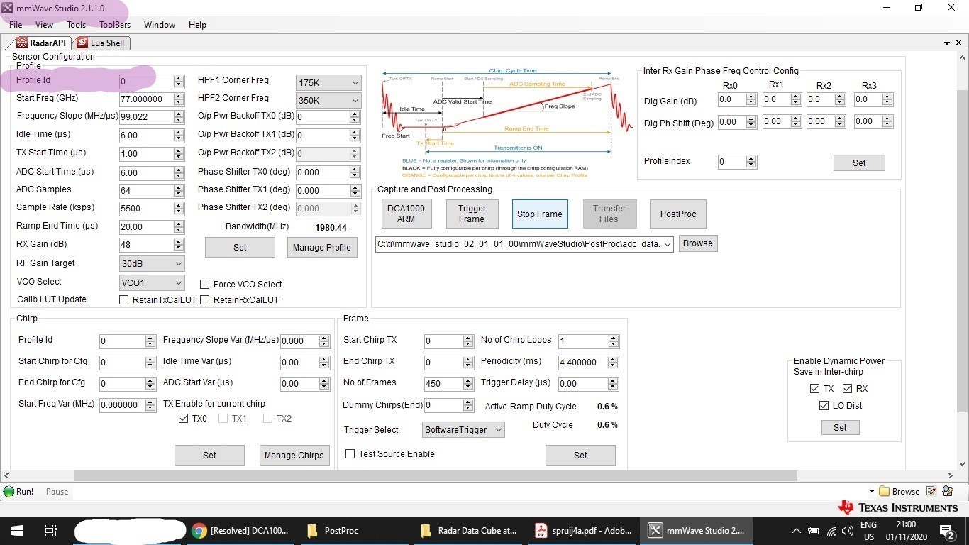

7)  For certain reasons, I was not willing to use mmwave Studio 2.1.1.0. However, in the face of this issue, after above attempts, I programmed the DCA1000 with version 2.8 of FPGA file and tried to use mmwave Studio 2.1.1.0 with Advanced Frame Config. This time a new error occurred. I am using the following chirp configuration in all cases:
FIGURE 3

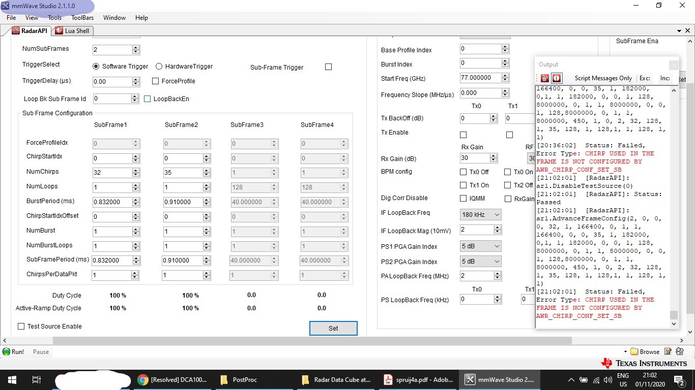

Now when I tried to program 450 frames with each frame having subframe1 of 32 chirps and subframe2 of 35 chirps, (as I tired earlier with mmwave Studio 2.0.0.2) , then now mmwave Studio 2.1.1.0 gave a new error when I attempted to use Advanced Frame Config. The following figure shows the situation and the error is
Error Type: CHIRP USED IN THE FRAME IS NOT CONFIGURED BY AWR_CHIRP_CONF_SET_SB
FIGURE 4
Please advise how can I resolve this error in mmwave Studio 2.1.1.0 for using Advanced Frame Config. I think that in Figure 3 , in Profile ID 0, i have set the the Chirp configuration in SensorConfig tab and I am using the same chirp in both subframes of all 450 frames so  I should not be getting this error. I repeat that I did the same but I did not this get this error in mmwave Studio 2.0.0.2, although, there, intermittently, the two other errors of corrupting of adcData matrix and RESP TIMEOUT Error, occurred. But at least this earlier stage passed and Advanced Frame Config tab passed the parameters successfully. But with mmwave Studio 2.1.1.0, even the step of Advanced Frame Config passing the parameters is not being succeeded.
Note that, the single chirp operations are going fine in mmwave Studio 2.1.1.0.

a)  I wish to use chirp configuration as shown in figure 3 (for example).
