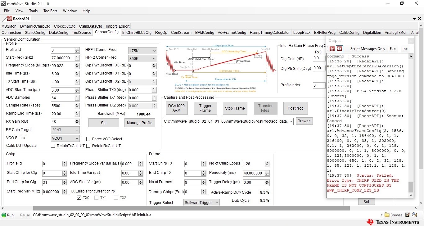

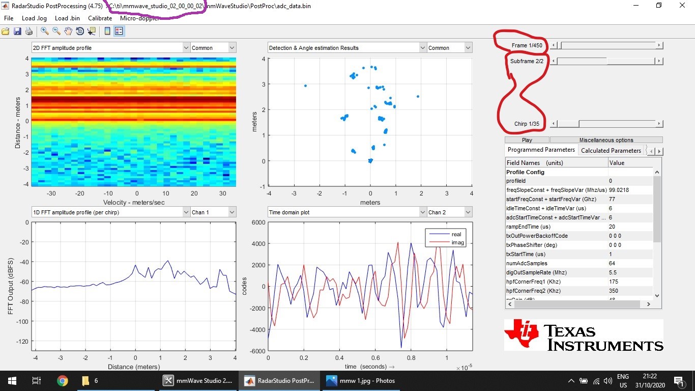

I am using AWR1642BOOST (ES2.0) + DCA1000 EVM, mmwave Studio 2.0.0.2 for acquiring adcData. I am using 16-bit ADC data in 2x Complex format for one Tx and two Rx. I have  tried to collect the data for 450 frames, with 4.4ms interframe time. I have used two sub-frames in one frame; one frame had 32 chirps and the 2nd subframe had 35 chirps. Both types of chirps had 26us chirp time for 64 adc samples/chirp.

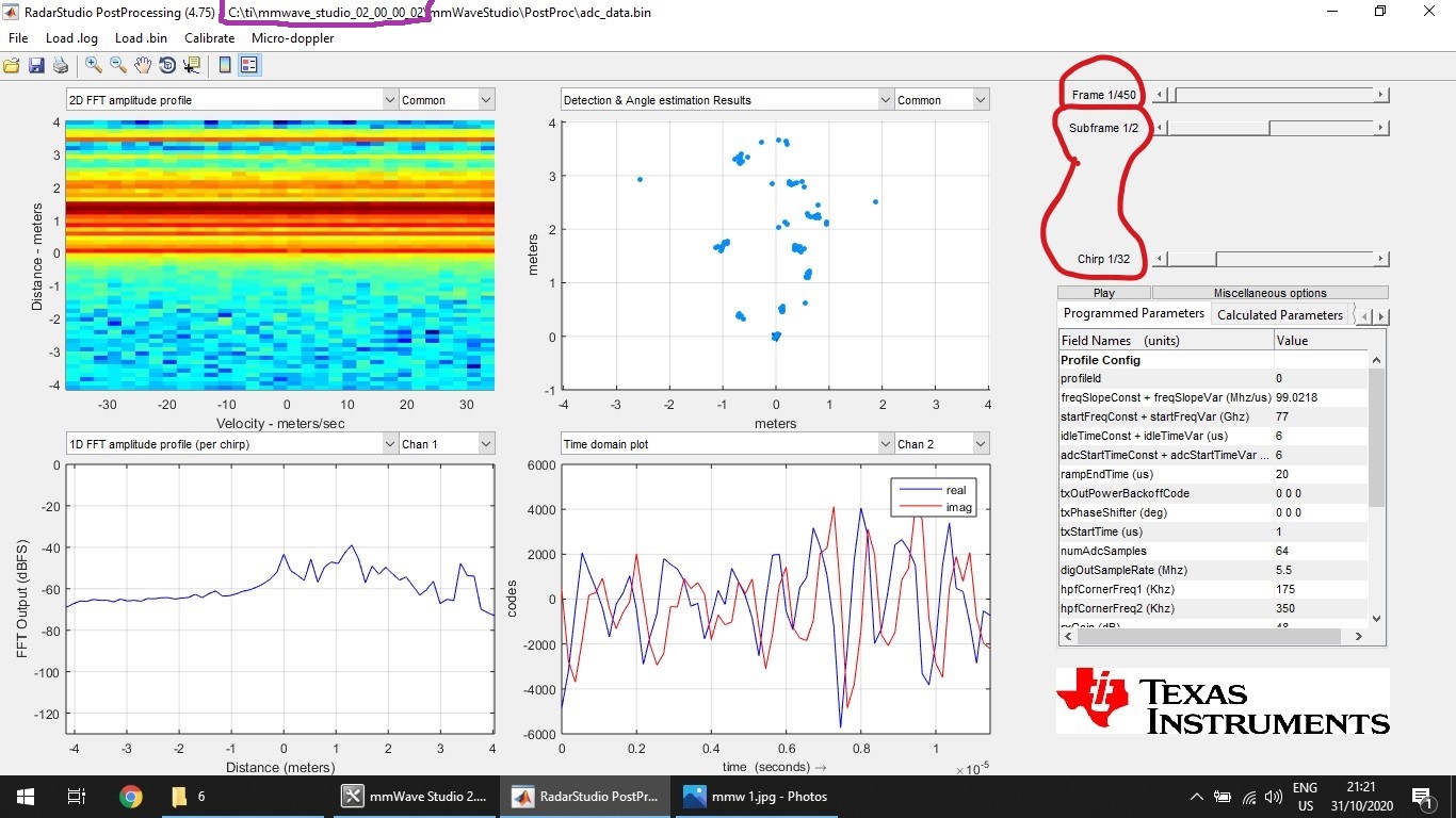

I tried to get the output on the GUI by using the PostProc utility of mmwave Studio. It SEEMS that it worked fine when I got the following figures:
FIGURE 1
FIGURE 2

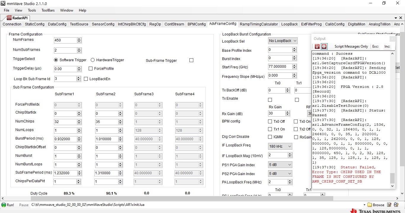

We can see above 450 frames and sub-frame one having 32 chirps and sub-frame 2 having 35 chirps.

1)   I am acquiring the adcData matrix produced by the DCA1000 EVM + mmwave Studio 2.0.0.2 for the above setup. I am using the MATLAB script provided by TI in the document mmwave Radar Device ADC Raw Data Capture (swra581b.pdf), for this purpose. For a use case of 2 Rx, the adcData produced by this MATLAB code should have a dimension of m x n, where
m = 2 rows ( for 2 Rx)   and
n = 64 adc samples / chirp  x  (  (32 chirps/subframe1 +35/subframe2 = ) 67 chirps / frames )  x  450 frames = 64 x 67 x 450 = 1929600 columns
Some times, not always, I obtain SUPPOSEDLY correct results from PostProc , as shown in Figure 1 and 2 above, and the adcData matrix also has correct number dimensions as calculated above.
However, many times, the adcData matrix for this case (by using above TI provided MATLAB code) gives a matrix having dimension of 2 x 2048 , instead of 2 x 1929600. Can you please help ?
2)   A connected fact is that after when the above error has occurred, then, after that, when I try to re-capture the adc data,  then RESP TIMEOUT Error occurs.

6)   Some queries about AdvFrameConfig  in mmwave Studio 2.0.0.2 :
Please refer above information in the start of this question. Then pls refer AdvFrameConfig
a)  What is the correct way to assign 32 chirps to subframe-1. Should I use NumChirps = 32 and  NumLoops = 1 ? Or should I use NumChirps = 1 and NumLoops = 32 ? Both these options are identical or not? If not then what is the difference ?
b) At the top of AdvFrameConfig, number of Frames are defined . Say I need 450 frames. If I set Number of frames = 450 here then do I also need to set to number of frames as 450 in frames sub-tab of SensorConfig tab ?
And how to set number of chirp loops in Frame sub-tab of SensorCOnfig tab, in this case. I set the number fo chirp loops to 1 in this case and I set the Advance Frame Config after this command so I assume that the Advance Frame Config overwrites the Frame Sub-tab of SensorConfig tab.

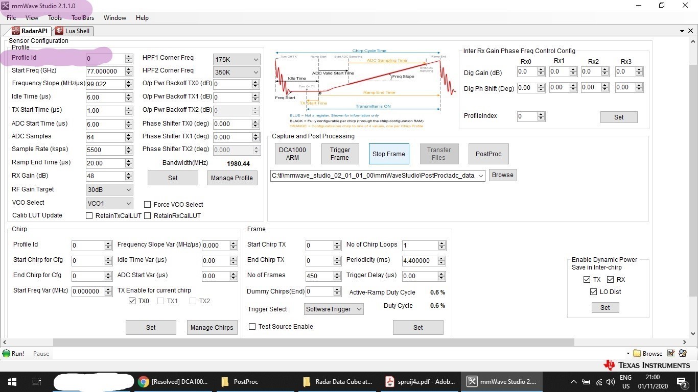

7)  For certain reasons, I was not willing to use mmwave Studio 2.1.1.0. However, in the face of this issue, after above attempts, I programmed the DCA1000 with version 2.8 of FPGA file and tried to use mmwave Studio 2.1.1.0 with Advanced Frame Config. This time a new error occurred. I am using the following chirp configuration in all cases:

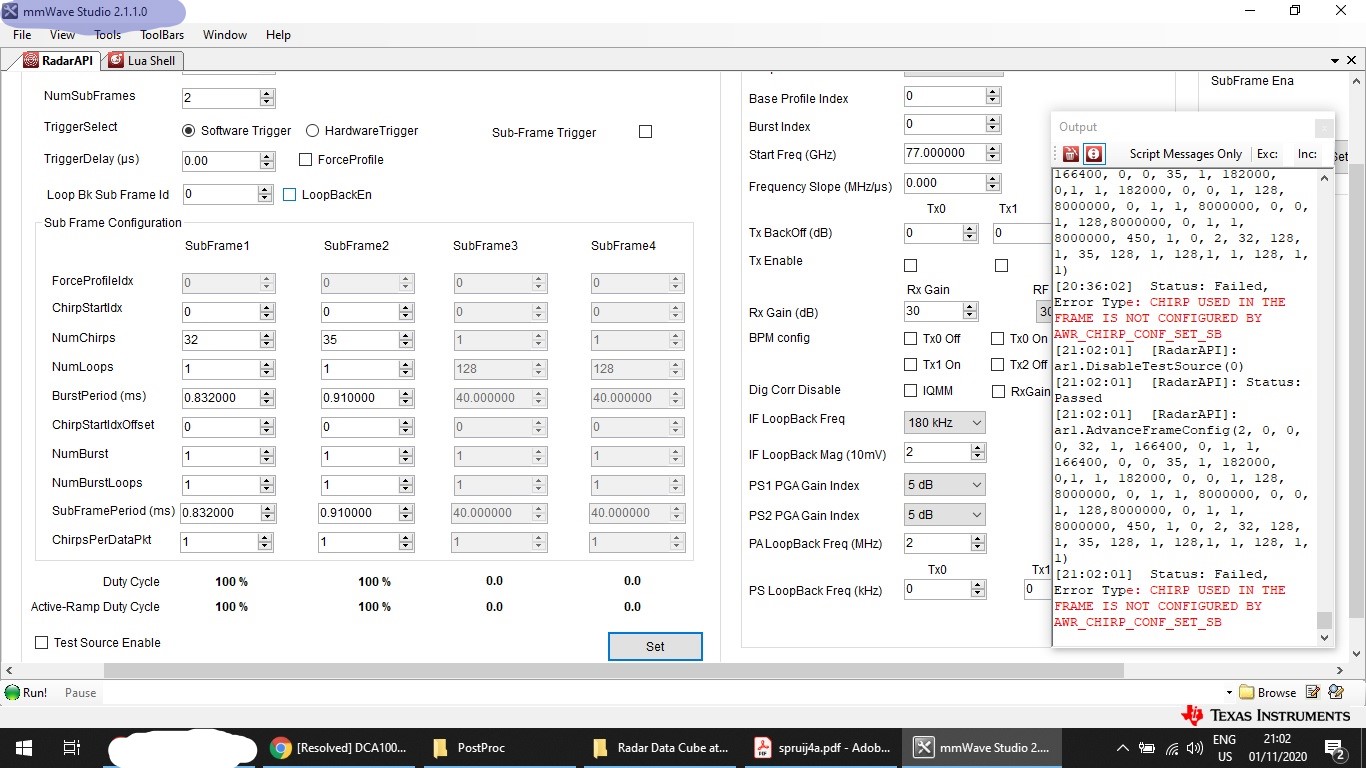

FIGURE 3
Now when I tried to program 450 frames with each frame having subframe1 of 32 chirps and subframe2 of 35 chirps, (as I tired earlier with mmwave Studio 2.0.0.2) , then now mmwave Studio 2.1.1.0 gave a new error when I attempted to use Advanced Frame Config. The following figure shows the situation and the error is
Error Type: CHIRP USED IN THE FRAME IS NOT CONFIGURED BY AWR_CHIRP_CONF_SET_SB
FIGURE 4
Please advise how can I resolve this error in mmwave Studio 2.1.1.0 for using Advanced Frame Config. I think that in Figure 3 , in Profile ID 0, i have set the the Chirp configuration in SensorConfig tab and I am using the same chirp in both subframes of all 450 frames so  I should not be getting this error. I repeat that I did the same but I did not this get this error in mmwave Studio 2.0.0.2, although, there, intermittently, the two other errors of corrupting of adcData matrix and RESP TIMEOUT Error, occurred. But at least this earlier stage passed and Advanced Frame Config tab passed the parameters successfully. But with mmwave Studio 2.1.1.0, even the step of Advanced Frame Config passing the parameters is not being succeeded.
Note that, the single chirp operations are going fine in mmwave Studio 2.1.1.0.

a)  I wish to use chirp configuration as shown in figure 3 (for example).
b)  I wish to transmit, say, 3 sets of the single chirp configuration defined in (a) above. Means that all chirps will be identical in all three sets but the numbers of chirps in 3 sets will be different. The ttotal number of all transmitted sets can be, say, 450.
c)  I can use burst, subframe, frame or any other way to from three sets of same chirps but having different number of chirps in each set. I will use each set as a CPI to get 2D FFT of chirps contained in one set. And  I wish the inter-set time to be as small as possible.

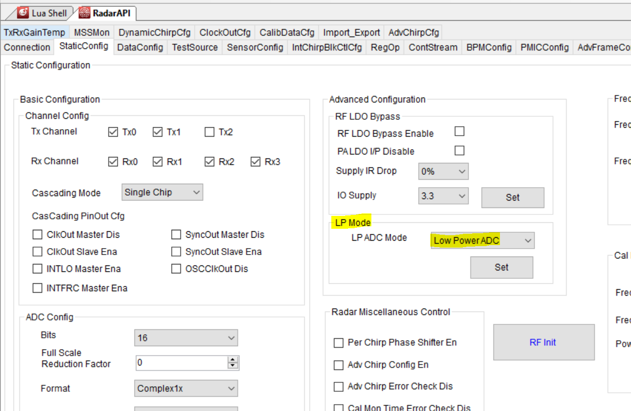

  • Hello Badar,
    If I just glance through your issue, I see you're using mmWave studio 02_00_00_02 and DCA1000 FPGA version 2.7
    We actually recommend using FPGA version 2.8 because there were some bug fixes related to the the RESP TIMEOUT error you're facing with FW version 2.7, so I guess it would be best to upgrade to version 2.8.
    Now also, the error you're getting with mmWave studio 02_01_01_00, points to the fact that you've not configured the chirps. So here I just want to confirm a small thing, did you press two "set" buttons on the sensorConfig tab? i.e one for the profile config and another one for the chirp config which is to the bottom left of the tab? and only after pressing these two "set" buttons, you move the the Advance Frame Config tab.
    Can you confirm once on this?

  • Hi Ishita,
    Thank you for your reply.
    1)   Thank you for the latest link to the Radar Interface Control Document.
    2)   I was already thinking that earlier mmwave Studio might have issue. Therefore, although, I had some limitation and I did not want to do that, but as I wrote and you know, now I am working on mmwave Studio 2.1.1.0 with rev 2.8 FPGA on DCA 1000.
    3)  I tried again and  I confirm that I pressed the 1st set button for Profile Config and I pressed the 2nd set button for Chirp Config , both of them located in Sensor Config tab and only after that, I moved to Advanced Frame Config tab.
    But the problem persists.

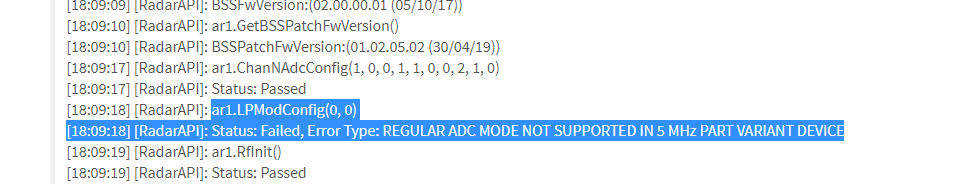

    [18:09:17] [RadarAPI]: ar1.ChanNAdcConfig(1, 0, 0, 1, 1, 0, 0, 2, 1, 0)
    [18:09:17] [RadarAPI]: Status: Passed
    [18:09:18] [RadarAPI]: ar1.LPModConfig(0, 0)
    [18:09:18] [RadarAPI]: Status: Failed, Error Type: REGULAR ADC MODE NOT SUPPORTED IN 5 MHz PART VARIANT DEVICE
    [18:09:19] [RadarAPI]: ar1.RfInit()
    [18:09:19] [RadarAPI]: Status: Passed

    [18:12:23] [RadarAPI]: ar1.AdvanceFrameConfig(2, 1536, 0, 0, 32, 1, 166400, 0, 1, 1, 166400, 0, 0, 35, 1, 182000, 0,1, 1, 182000, 0, 0, 1, 128, 8000000, 0, 1, 1, 8000000, 0, 0, 1, 128,8000000, 0, 1, 1, 8000000, 450, 1, 0, 2, 32, 128, 1, 35, 128, 1, 128,1, 1, 128, 1, 1)
    [18:12:23] Status: Failed, Error Type: CHIRP USED IN THE FRAME IS NOT CONFIGURED BY AWR_CHIRP_CONF_SET_SB

  • Hello Badar,
    Thanks for sending the the studio log. It is definitely useful as now I understand what you're trying to do.
    There are a couple of points here:
    1. As you're using AWR1642 device variant, please note that only Low Power ADC mode is supported. As you can see in your studio log, you have got an error with Regular Mode. It shows the status as "failed".
    Hence Please select "Low Power ADC" in the LP mode command on StaticConfig Tab. I have highlighted that for you below as well.
    2. From your pasted log, I also see you're following a wrong sequence for configuring advance frames. Below is the correct sequence :
    • You can configure the DCA1000 capture card first by pressing the "Set up DCA1000" button. Although it's not necessary to to configure this first, but we usually prefer this before we start with the chirp settings or completely after that.
    • Now we can start with the chirp configurations: First you configure the Chirp profile in the "SensorConfig" Tab. (This is done correctly by you)
    • Second is the "chirp" configuration. (correctly done by you)
    • Now you need to directly jump to the "AdvFrameConfig" Tab and configure the burst/subframes and frames. Please note while using Advance frames, you need not configure the legacy frames in the SensorConfig Tab.
    • Now in order to capture the data, press the "DCA1000 ARM" button in the "SensorConfig" Tab and after waiting for around 1 sec, press "Trigger frames".
    You were getting the chirp configuration missing error because you were configuring both Advance and legacy frames. Please follow the correct sequence and let us know if you're facing any other problem.
    Hope this helps.
    Ishita
  • Hi Ishita,
    Thank you very much for your detailed study of the code. I acted as you advised but the problem persists, so far. Please have a looK at the following notes and please note again that I am using AWR1642BOOST (ES2.0) + DCA1000 EVM on mmwave Studio 2.1.1.0, version 2.8 DCA FPGA file.
    1)  I have been using Low Power ADC mode because I have studied in some TI mmwave documents that suggest Regular ADC power mode for xwr16xx devices (you may refer mmwave SDK 3.4.0.3 having mmwave SDK User Guide Release 3.4, Document Version 1.0 , page 23). In addition, I have been getting this error message for quite a while as I was using regular ADC mode but as it was not in red color so I did not bother much about it. And more importantly, I was not facing any problem and even in spite f this black color error message, things were working fine.
    However, still, on your advice, I just now used Low Power ADC mode but the problem persists.
    2)  I was configuring DCA1000 EVM after configuring the profile, the chirp and the frame. This is the sequence that is advised in User Guide for mmwave Studio 2.1.1.0, figure 9.3. However, as per your advice, I have attempted by first clicking the DCA Setup and then clicking the Profile Config, then Chirp Config and then went to Advanced Frame Config but the problem persists.
    3)  I have another query that if I just use Advanced Frame Config and if I just dont use Frame sub-tab in Sensor Config (and I did the same recently after your advice) then how, when and where the inter-frame time period will be set ?
    4)  I further think that even if I had pressed the frame sub-tab in Sensor Config tab and after thaT if I had used Advanced Frame Config tab then the later would have over ridden the previous frame config , except the values one that are not entered in the later i.e. Advanced Frame Config, for example, I dont see inter frame time setting in Advanced Frame Config tab. However, this is just my thought, may be you can comment further. But I did exactly as you advised.

    [11:40:14] [RadarAPI]: ar1.AdvanceFrameConfig(2, 1536, 0, 0, 32, 1, 166400, 0, 1, 1, 166400, 0, 0, 35, 1, 182000, 0,1, 1, 182000, 0, 0, 1, 128, 8000000, 0, 1, 1, 8000000, 0, 0, 1, 128,8000000, 0, 1, 1, 8000000, 450, 1, 0, 2, 32, 128, 1, 35, 128, 1, 128,1, 1, 128, 1, 1)
    [11:40:15] Status: Failed, Error Type: CHIRP USED IN THE FRAME IS NOT CONFIGURED BY AWR_CHIRP_CONF_SET_SB

    [12:09:03] [RadarAPI]: ar1.ChanNAdcConfig(1, 0, 0, 1, 1, 0, 0, 2, 2, 0)
    [12:09:04] [RadarAPI]: Status: Passed
    [12:09:05] [RadarAPI]: ar1.LPModConfig(0, 0)
    [12:09:05] [RadarAPI]: Status: Failed, Error Type: REGULAR ADC MODE NOT SUPPORTED IN 5 MHz PART VARIANT DEVICE

    [12:09:55] [RadarAPI]: ar1.ProfileConfig(0, 77, 6, 6, 20, 0, 0, 0, 0, 0, 0, 99.022, 1, 64, 5500, 0, 0, 48)
    [12:09:55] [RadarAPI]: Status: Passed
    [12:09:56] [RadarAPI]: ar1.ChirpConfig(0, 0, 0, 0, 0, 0, 0, 1, 0, 0)
    [12:09:56] [RadarAPI]: Status: Passed

    [12:10:57] [RadarAPI]: ar1.AdvanceFrameConfig(2, 1536, 0, 0, 32, 1, 166400, 0, 1, 1, 166400, 0, 0, 35, 1, 182000, 0,1, 1, 182000, 0, 0, 1, 128, 8000000, 0, 1, 1, 8000000, 0, 0, 1, 128,8000000, 0, 1, 1, 8000000, 450, 1, 0, 2, 32, 128, 1, 35, 128, 1, 128,1, 1, 128, 1, 1)
    [12:10:57] Status: Failed, Error Type: CHIRP USED IN THE FRAME IS NOT CONFIGURED BY AWR_CHIRP_CONF_SET_SB
    [12:11:06] [RadarAPI]: ar1.CaptureCardConfig_StartRecord("C:\\ti\\mmwave_studio_02_01_01_00\\mmWaveStudio\\PostProc\\adc_data.bin", 1)
    [12:11:06] [RadarAPI]: Sending start_record command to DCA1000
    [12:11:10] [RadarAPI]: ar1.StartFrame()
    [12:11:10] Status: Failed, Error Type: NO VALID FRAME CONFIGURATION API WAS ISSUED AND FRAMES ARE STARTED-
  • Hello Badar,
    Now let us consider your subframe 1.
    You said you want 32 chirps in that frame. Does that mean that you want 32 different chirp from chirp index 0 to 31 or do you want chirp 0 to be repeated 32 times? I'm asking this because these are two different configurations and this is the reason you're getting the error. Let me explain a bit more about this.
    In the SensorConfig Tab, you issue the API ar1.ChirpConfig(0, 0, 0, 0, 0, 0, 0, 1, 0, 0). This means you're only configuring chirp 0. Whereas in contradiction to this, in the AdvFrameConfig Tab, you are entering "NumChirps" as 32 and "NumLoops" as 1 (which points to the direction that you are configuring 32 chirps here, but you have defined only chirp 0 in the "SensorConfig" Tab. This is the reason you're getting the Error Type: CHIRP USED IN THE FRAME IS NOT CONFIGURED BY AWR_CHIRP_CONF_SET_SB.
    This is because Chirp 1 to Chirp 31 are not defined by you.
    1. One solution to this is, just correct your input in the AdvFrameConfig Tab. Make NumChirps as 1 and NumLoops as 32.
    2. Second solution, keep your inputs in the AdvFrameConfig Tab same but change your Chirp Config in SensorConfig Tab : ar1.ChirpConfig(0, 31, 0, 0, 0, 0, 0, 1, 0, 0)
    I guess this was a confusion due to understanding of the Advance Frame Parameters. You can refer to the mmWave DFP user guide.pdf (Chapter 11.1) to understand about programming the parameters.
    Hope the information was clear.

    [19:35:26] [RadarAPI]: ar1.LPModConfig(0, 0)
    [19:35:26] [RadarAPI]: Status: Failed, Error Type: REGULAR ADC MODE NOT SUPPORTED IN 5 MHz PART VARIANT DEVICE

    [19:36:10] [RadarAPI]: ar1.ProfileConfig(0, 77, 6, 6, 20, 0, 0, 0, 0, 0, 0, 99.022, 1, 64, 5500, 0, 0, 48)
    [19:36:10] [RadarAPI]: Status: Passed
    [19:36:14] [RadarAPI]: ar1.ChirpConfig(0, 31, 0, 0, 0, 0, 0, 1, 0, 0)
    [19:36:14] [RadarAPI]: Status: Passed

    [19:37:30] [RadarAPI]: ar1.AdvanceFrameConfig(2, 1536, 0, 0, 32, 1, 186400, 0, 1, 1, 246400, 0, 0, 35, 1, 202000, 0,1, 1, 262000, 0, 0, 1, 128, 8000000, 0, 1, 1, 8000000, 0, 0, 1, 128,8000000, 0, 1, 1, 8000000, 450, 1, 0, 2, 32, 128, 1, 35, 128, 1, 128,1, 1, 128, 1, 1)
    [19:37:30] Status: Failed, Error Type: CHIRP USED IN THE FRAME IS NOT CONFIGURED BY AWR_CHIRP_CONF_SET_SB

  • Hello Badar,
    Please find my comments below:
    3) As shown, it still gives you an error status as failed, so you should take care and use only low power mode for this. I'm not completely sure of the implication of the setting here, will need to check with the internal team.
    4) Need to check on this.
    5 & 6) The ICD only reports the maximum conditions or limitations that you must always consider. The 50% usecase is a suggestion or a typical usecase.
