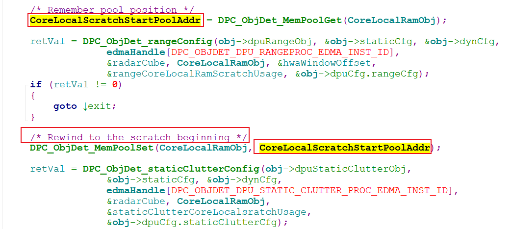

However i have some doubt about it.See the next picture:
When DPC_ObjDet_rangeConfig is called, a further function DPC_ObjDet_MemPoolAlloc is called:
windowBuffer is allocated(This is a address allocate from CoreLocalRamObj),once DPC_ObjDet_rangeConfig is finished,the DPC_ObjDet_MemPoolSet function make the CoreLocalRamObj's currAddr rewind to the scratch beginning,then DPC_ObjDet_staticClutterConfig is called.So the windowBuffer's(rangeCfg.staticCfg.window) memory is overwritten.What remedy do I have for not finding follow-up code.Why???

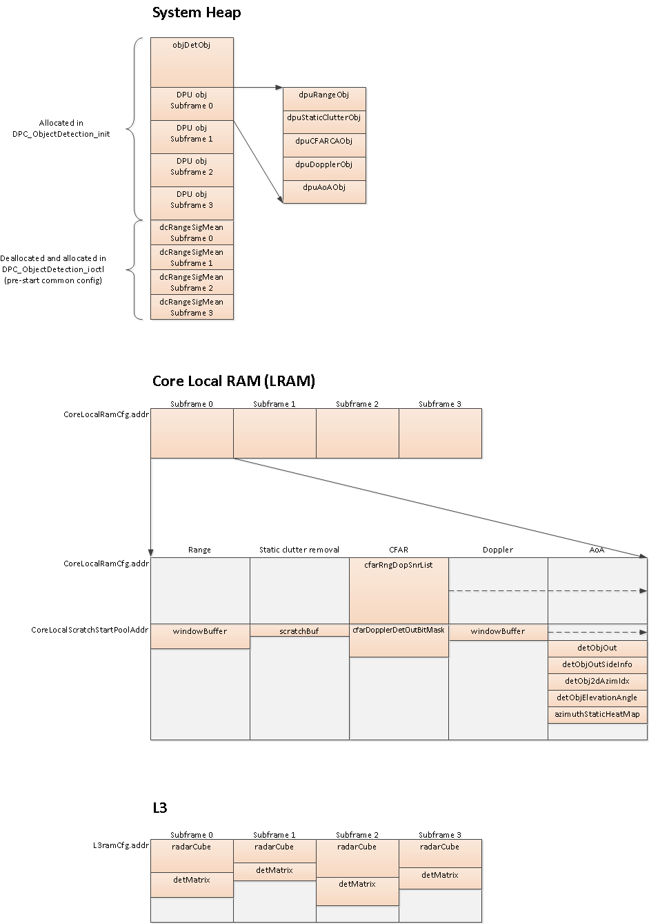

  • Hi Bryant,
    This is actually a feature of the DPC. The scratch memory used by all DPUs is overlapped (starting at the same address). As only one DPU executes at a time, it has sole access to the scratch memory while it is executing. When executing, the DPU uses its scratch memory. The next DPU to execute overwrites this memory for its own computations.
    DPC_ObjDet_MemPoolAlloc doesn't work like normal alloc functions. It doesn't reserve/allocate memory from the system heap, It just returns an address and advances MemPoolObj which is pointing to a memory that has already been allocated. In the case of mmwave demo, CoreLocalRamObj is allocated once in the dss_main.c as global variable (gDPC_ObjDetL2Heap) and passed to the DPC through DPM_init.
    Have a look at the following diagram from the HWA DPC's doxygen document for a visual representation of the memory layout:
    A little context for the image:
    • If you want memory to persist across subframes, allocate it on the system heap with MemoryP_ctrlAlloc (eg: dcRangeSigMean) and later deallocate it with MemoryP_ctrlFree manually.
    • If you want memory to persist within a subframe across all DPU computations, "allocate" it with DPC_ObjDet_MemPoolAlloc before "allocating" the scratch buffers (eg: cfarRngDopSnrList)
    • If you want memory to persist only when a DPU is being executed, "allocate" it  within DPC_ObjDet_<DPU>config and then rewind the memory pool to CoreLocalScratchStartPoolAddr so the next DPU can also "allocate" the same memory (eg: windowBuffer, scratchBuf, cfarDopplerDetOutBitMask, etc)
    In cases 2 and 3, actual allocation happened in dss_main.c.  DPC_ObjDet_MemPoolSet, DPC_ObjDet_MemPoolGet and DPC_ObjDet_MemPoolAlloc are just accounting functions that don't do any actual allocation from the system.
    To summarize,
    Since only one DPU executes at a time, the scratch buffers used by these DPUs share the same physical memory which is allocated . This is why after every DPC_ObjDet_<DPU>config function, DPC_ObjDet_MemPoolSet is called to rewind and start allocation from CoreLocalScratchStartPoolAddr again.
    Aayush

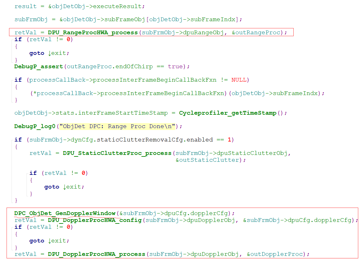

    In function of DPC_ObjectDetection_execute,see follow picture:
    if rewind and start allocation from CoreLocalScratchStartPoolAddr,when DPU_RangeProcHWA_process is called, we should DPC_ObjDet_GenRangeWindow,it do not execute it.However before DPU_DopplerProcHWA_process it called the DPC_ObjDet_GenDopplerWindow.
    I hope to get your answer soon.

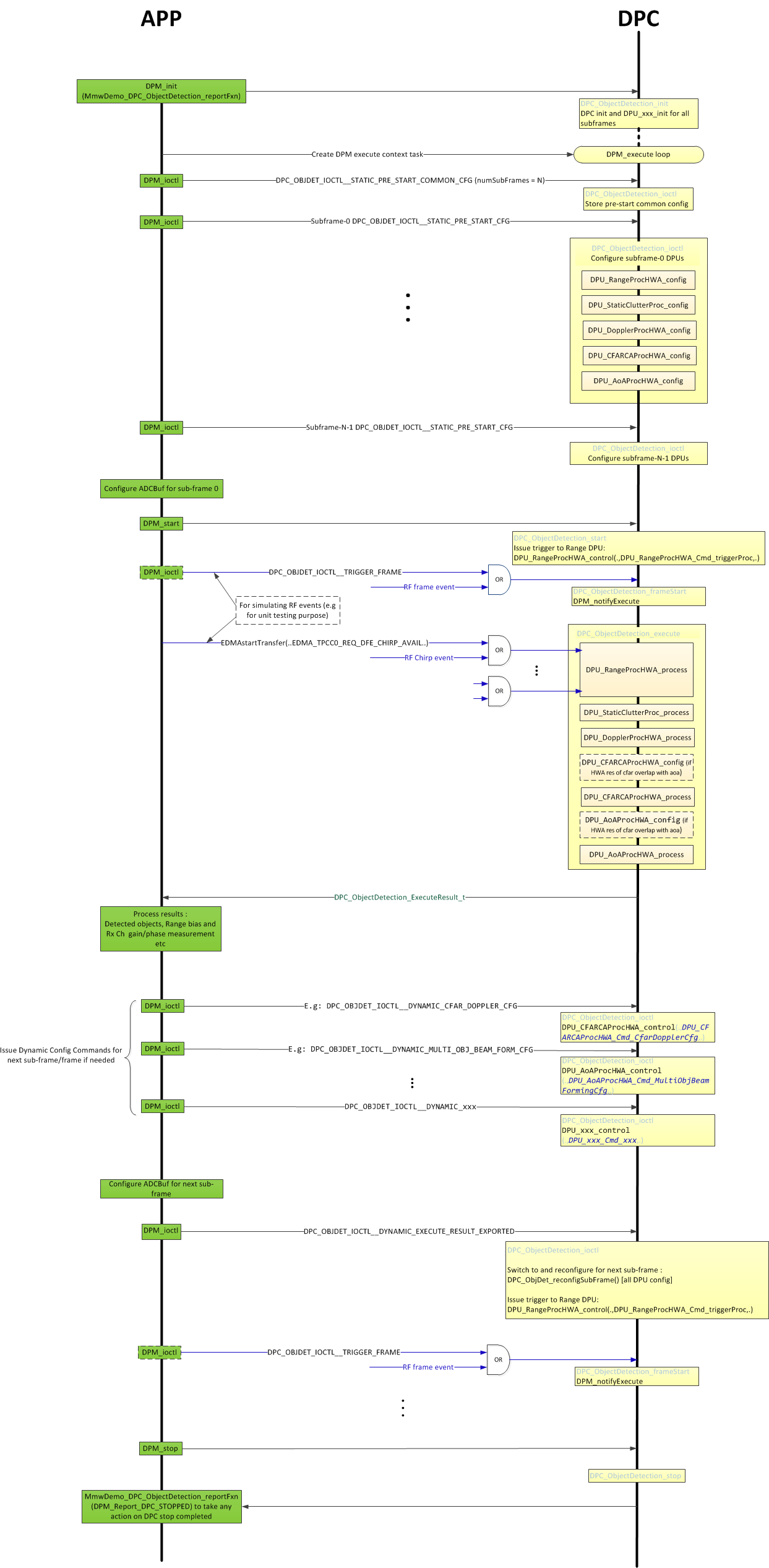

    Your understanding is correct for the most part. You can have a look at the doxygen document for an overview of the order of execution of these functions. Here is the execution flow diagram:
    How the config functions are called (for HWA based DPC):
    User application->DPM_ioctl(DPC_OBJDET_IOCTL__STATIC_PRE_START_CFG) (for each subframe)-> DPC_ObjectDetection_ioctl->DPC_ObjDet_preStartConfig->(calls all DPC_ObjDet_<DPU>Config)
    Once this is complete, user application starts the sensor by calling DPM_start and then MMWave_start.
    After this the frames start coming in.
    When a frame starts, DPM gets a frameStartSysInterrupt interrupt from RF. DPM notifies this to DPC by calling DPC_ObjectDetection_frameStart, which was registered with the DPM.
    DPC_ObjectDetection_frameStart checks if last subframe's processing has finished, and if so, calls DPM_notifyExecute to notify the DPM that the DPC is ready to be executed. DPM_notifyExecute posts a semaphore ptrDPM->semaphoreHandle.
    Then, the DPM_execute function which was pending on the semaphore (which is being called in the user application in a loop) starts and calls DPC_ObjectDetection_execute.
    DPC_ObjectDetection_execute calls all the DPU_<dpuname>HWA_process functions.
    To summarize,
    The DPU config functions are called first at the time of configuration of the device. Then, when the frames start (for HWA case), DPC execute is called, which calls all DPU process functions.

    All config functions are executed in turn. However, the windowbuffer allocated in DPC_ObjDet_rangeConfig will not get overwritten by DPC_ObjDet_staticClutterConfig. This is because the DPC_ObjDet_MemPoolAlloc function does not modify the underlying memory. It just returns a pointer to a memory location that can be used later by the DPU process functions.
    So, windowBuffer now points to a memory location in the scratch memory region, which is used by all DPUs. When DPU_RangeProcHWA_process is being executed, it is the only function to have access to the scratch buffer, and hence can access the memory pointed to by windowBuffer.
    After this, DPU_StaticClutterProc_process uses the same memory location for its scratchBuf, so windowBuffer gets overwritten. This is okay as the rangeproc windowBuffer is no longer needed.
    As for the last part of your post,
    Refer to the memory allocation diagram in my previous reply. The windowBuffer in the Doppler DPU is needed by the AoA DPU. So, Memory pool rewind isn't done after DPC_ObjDet_dopplerConfig. This is also why in DPC_ObjectDetection_execute, there are DPU_DopplerProcHWA_config and DPU_CFARCAProcHWA_config calls.
    The DSP based DPC allocation is more straightforward as the doppler windowBuffer is not allocated in scratch memory region.
    I'd also suggest taking a look at the DPC_ObjDet_MemPoolAlloc, DPC_ObjDet_MemPoolGet and DPC_ObjDet_MemPoolSet function implementations to see exactly what they are doing.
    Aayush

  • Hi Bryant,
    Let me know if I'm wrong, but I think you might be under the impression that the successive DPU config calls overwrite the previous DPU scratch memories. If I am correct in the understanding your question,
    Yes, the scratch memory objects (rangeproc windowBuffer etc) will get overwritten, but not by the DPU config functions (DPC_ObjDet_staticClutterConfig and the rest).
    The rangeproc windowBuffer allocated during DPC_ObjDet_rangeConfig is not overwritten by DPC_ObjDet_staticClutterConfig.
    It will be used for the first and only time in DPU_RangeProcHWA_process and then get overwritten by DPU_StaticClutterProc_process when it writes to its scratchBuf array.
    Since rangeproc windowBuffer is only used during the execution of DPU_RangeProcHWA_process and at no other time, it doesn't matter if the data in it gets overwritten by other process functions later.
    I hope that answers your question. If not, please let me know.
    Aayush

    I check the code.The flow as follow:
    DPC_ObjDet_rangeConfig->DPC_ObjDet_MemPoolAlloc->DPC_ObjDet_GenRangeWindow
    DPC_ObjDet_GenRangeWindow :valid range window data is generated;
     DPC_ObjDet_staticClutterConfig &&  DPC_ObjDet_CFARCAconfig alloc the begining scratchBuf address,not generate data;
    DPC_ObjDet_dopplerConfig->DPC_ObjDet_MemPoolAlloc->DPC_ObjDet_GenDopplerWindow;
    DPC_ObjDet_GenDopplerWindow:valid Doppler window data is generated,so the range window data is overwriting.
    Is this a bug?
    Please check it.
    Thanks.

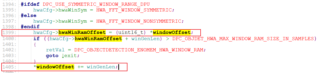

  • Hello, :
    In function DPC_ObjDet_rangeConfig,see as follow picture:
    I think line 1405 should be : hwaCfg->hwaWinRamOffset += winGenLen;Becuse the var of  *windowOffset do not use anymore.
    Please check it.
    Thanks.
    Bryant
  • Hi Bryant,
    This is fine. In DPC_ObjDet_preStartConfig, &hwaWindowOffset pointer is passed to DPC_ObjDet_rangeConfig as windowOffset. hwaWindowOffset is being added to by the statement:
    *windowOffset += winGenLen;
    This modified value is later used in DPC_ObjDet_dopplerConfig to copy its windowBuffer to the appropriate HWA RAM location.

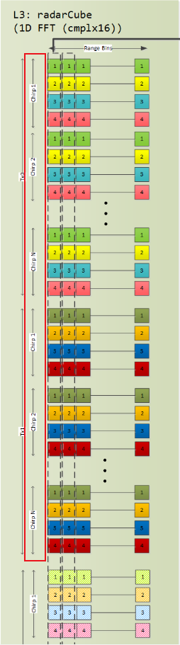

    In file:///C:/ti/mmwave_sdk_03_04_00_03_1/packages/ti/datapath/dpc/dpu/aoaproc/docs/doxygen/html/index.html,as this picture as follow(Blue box marking):
    Why doppler chirps are not 1,2,3,...,N but 1,4,..,N-2?
    I think 2D-FFT should be done N chirps.This makes me confused.Can you explain it?
    Thanks.
    Bryant
  • Hi Bryant,
    The hot signature channel is just called the signature channel. It copies a one-hot encoded vector.
    Reconfiguration after the chain has run for a frame is done when the DPC_OBJDET_IOCTL__DYNAMIC_EXECUTE_RESULT_EXPORTED is received.
    In the last diagram, all chirps are involved in the 2D FFT. 2nd chirp is available in the TX2.
    Aayush

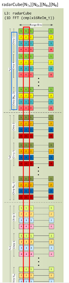

  • Hello, :
    In file:///C:/ti/mmwave_sdk_03_04_00_03_1/docs/mmwave_sdk_module_documentation.html,
    Why the follow four DPU's radarcube is
    But
    radarcube will be as followed picture:
    Where's the lost chirp?
    Thanks.
    Bryant
  • Hi Bryant,
    The same is used for TDM MIMO with AoA DPU.
    Aayush
